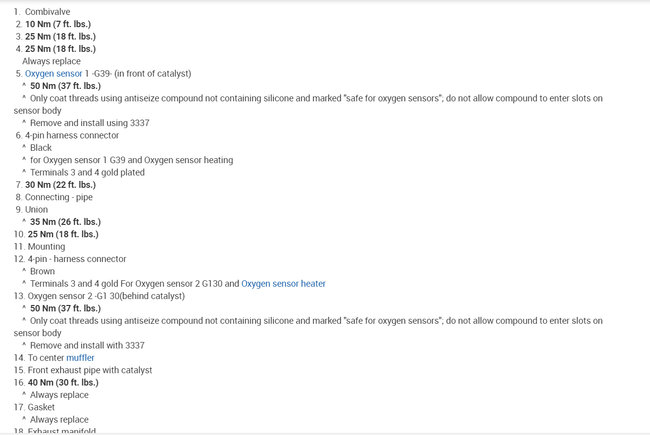

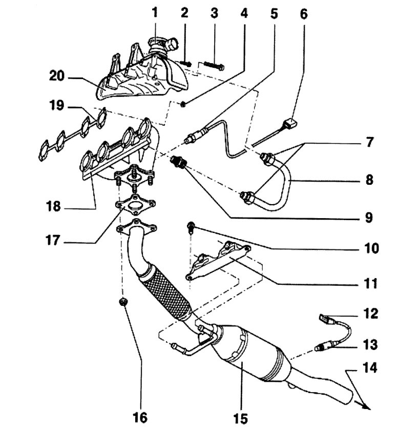

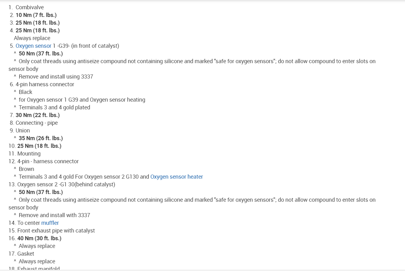

What is the nut size to install the catalytic converter onto the manifold?
2002 VOLKSWAGEN GOLF
135,000 MILES • 2.0L • 4 CYL • TURBO • 2WD • MANUAL
JEWELS17389
Hi, I’m having a hard time trying to figure out what nut size is required to install my catalytic converter onto the manifold on my car listed above GTI, everywhere I try to buy one it doesn’t include hardware other than sleeve and gasket. I even emailed and asked them what nut size is required and each of them told me they were unable to tell me, my car is parted out, so it is my project car. If you can let me know ASAP it would be appreciated. Thank uou

I believe it is a 17mm, but they can change, here is a video of the job being done on a similar car and I have included the instructions on how to change the catalytic converter out int he diagrams below.
