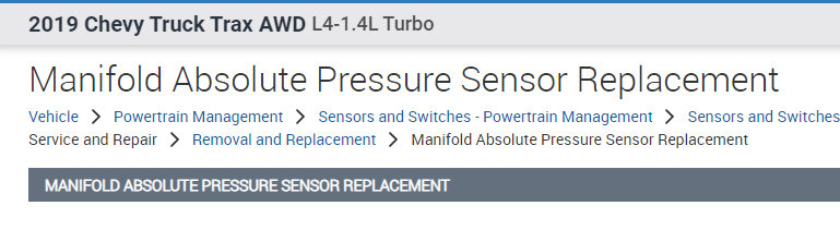

I need to purchase some parts. I located the parts I need. The description for the parts states that they only work for cars with 1 MAP sensor.
I have never seen this before. How would I determine the number of MAP sensors?

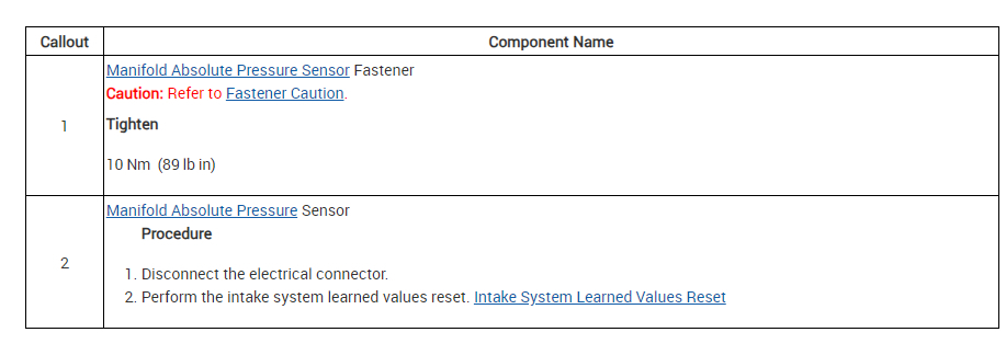

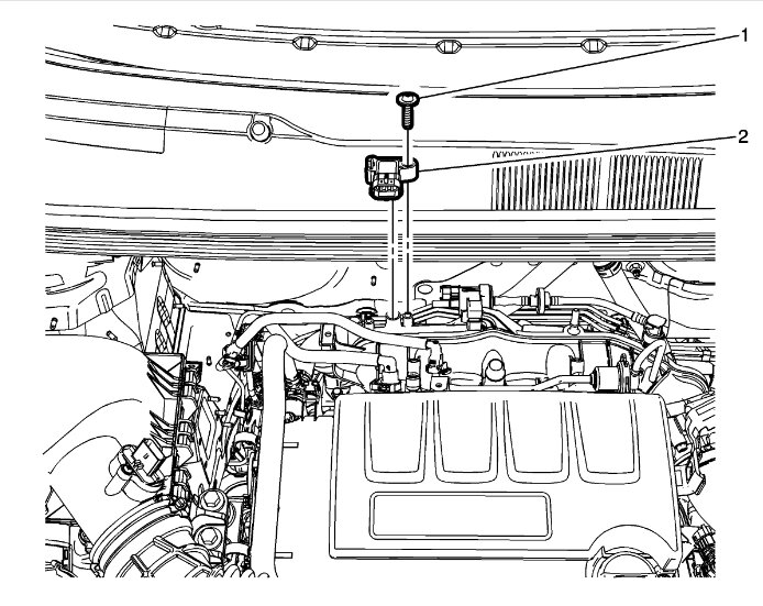

I don't believe I've ever seen a vehicle with two. Maybe they are referring to the intake air pressure/temperature sensor on this vehicle. However, it has one MAP sensor.
I attached directions below for replacing it.
Let me know if this helps.
