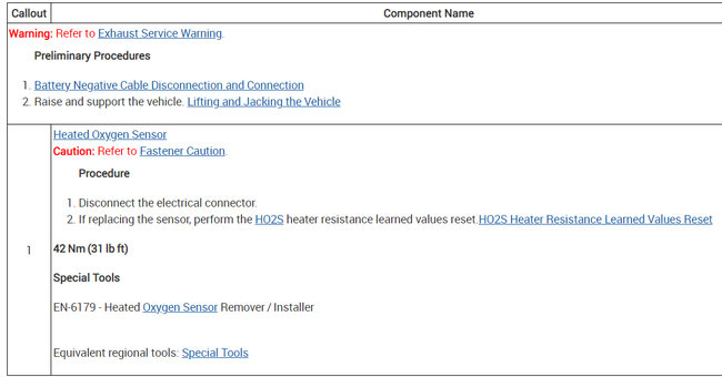

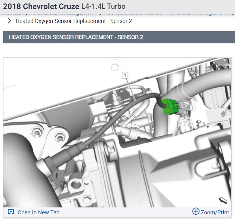

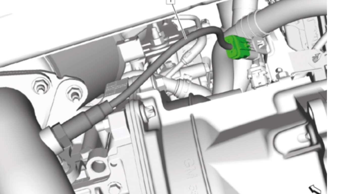

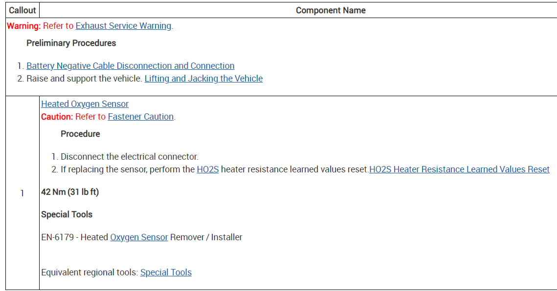

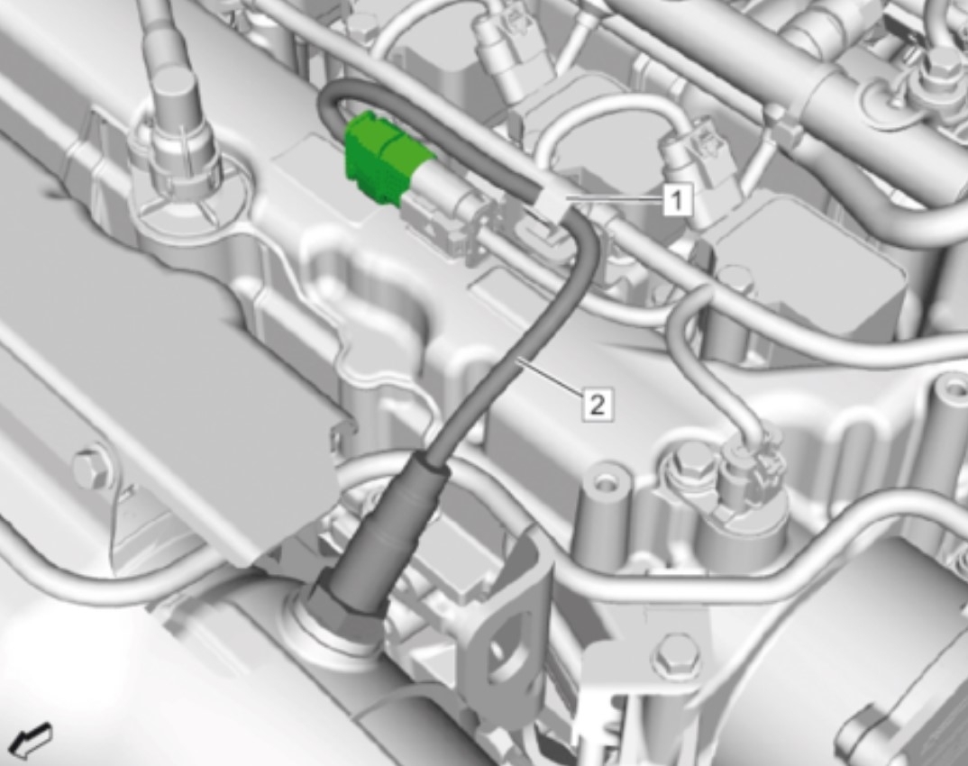

Let's go over these guides to help us figure out what's going on and I have included how to change out the oxygen sensor with the location in the images below.
https://www.2carpros.com/articles/how-to-replace-an-oxygen-sensor
and
Check out the images (below). Please upload pictures or videos in your response to the problem so we can see what's going on.

Where is sensor# 3 located? From the information i could get, on those 2 codes, it was showing, no matter what site i tried, that the bank number 2 sensor is bad.

The codes you posted are valid GM codes but don't seem to be in the code listing for the car you have. That said there is no sensor #3, just the two next to the converter. One on top of the engine and one under the car just after the converter. I would try a different scan tool first, one that can read that vehicle and allow you to watch the voltages from both sensors to see what they are doing. There is a known issue with the GM vehicles in cold weather, they form ice inside the runners of the intercooler and can cause rich codes because of it. Basically, it chokes the airflow. GM issued a service bulletin on it. It basically says to insulate parts of the intercooler ducting to keep the air warmer during very cold weather. Perhaps an OE level tool can get you better results.
