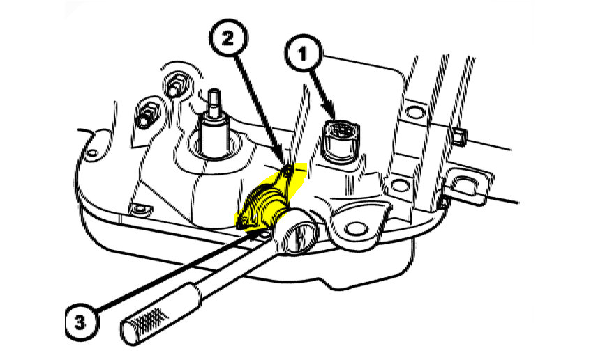

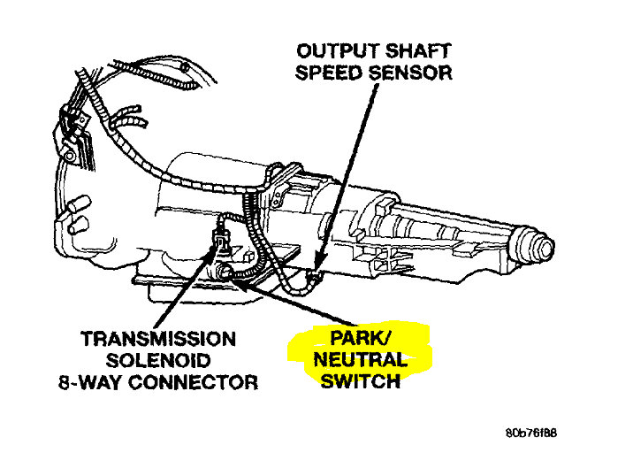

The park/neutral switch is located on the left side of the transmission (driver's side) behind the shift lever which the linkage attaches to.
If you look below, I attached two different pics showing the sensor. Check to see if it is located in that location. If it isn't, then it may be internal, so let me know.
Take care and let me know what you find.

I checked those places and couldn't find anything, and I even checked the internal transmission and still nothing. It's an SLT model and I think the transmission is 45rfe. Is there a switch that looks a certain way?

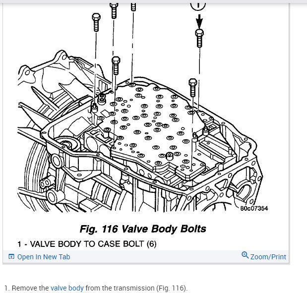

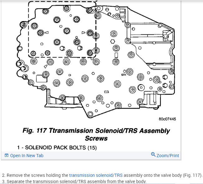

Interestingly, the manual is wrong. I rechecked the pics I sent and that certainly isn't where they are located on a 45RFE (4 speed). It clicked when I looked further. I never liked doing these because the TRS (transmission range sensor) is located on the top of the valve body.

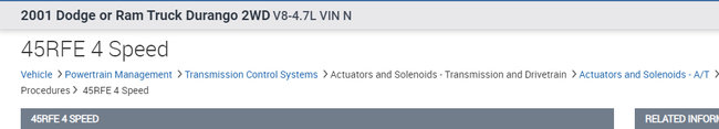

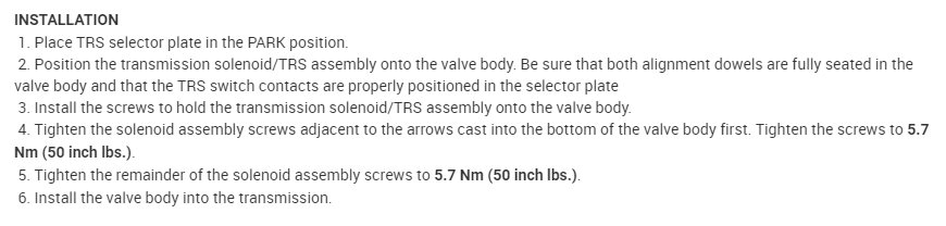

The valve body needs to be removed. I attached the directions below for replacing the TRS. However, before doing that, will it start in neutral? If it does, then this would be my first suspect.

I replaced a transmission solenoid in my vehicle listed above SLT and I also replaced the trs plate. When I put everything back into the transmission and all that the truck wouldn't start. The shift indicator light works on all gears except park and neutral.

If the indicator doesn't light for park or neutral, and you can't make them light if you shift slowly, you may have gotten a faulty range sensor. The TRS has six switches in it that determine shift lever position, supply ground to the Starter Relay in Park and Neutral only, and supply ground to the TCM for backup lamp control in Reverse only. Since the gears are working, the sensor is likely the issue.
