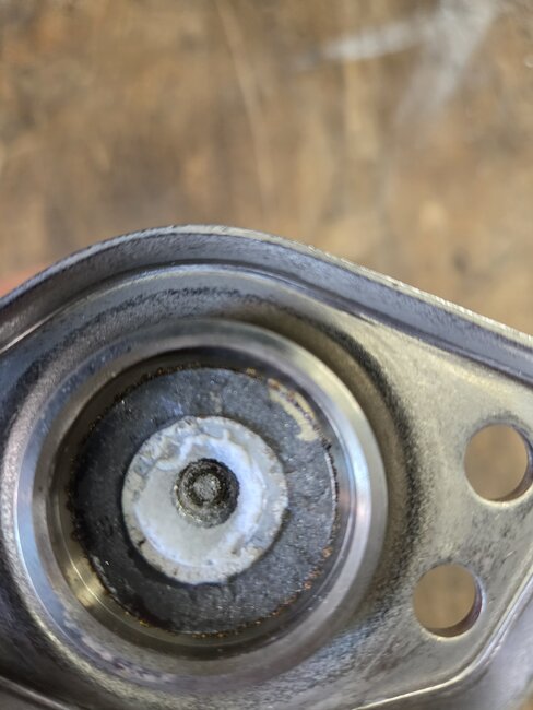

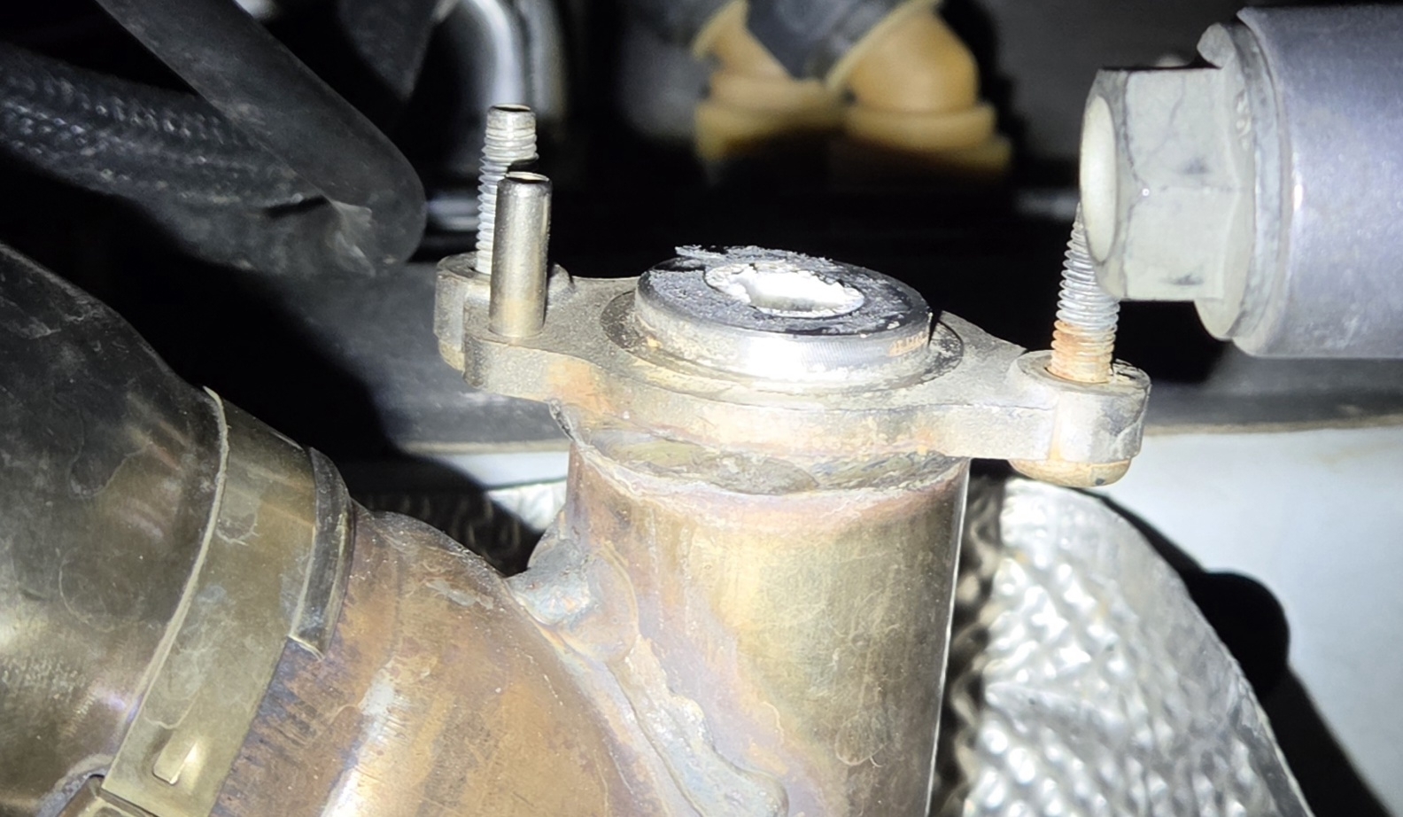

Here is what GM says:
DEF naturally crystallizes when the water portion evaporates, so deposits can form around the injector nozzle. Some crystallization does not necessarily mean the injector has failed. In fact, GM's diagnostic information indicates that deposits can sometimes be cleared by operating the injector during the quantity-test procedure.
When you remove it Monday, don't throw the old injector away. If you can, take a picture of the injector tip and the opening in the exhaust pipe before cleaning anything. Post those pictures here and we can see what the deposit pattern looks like.

Here are the pictures of the exhaust opening and the injector tip.
I cleaned the opening,and installed the new injector.
I cleared the codes, and did a DPF service regen.
I'll take it for a test drive later today...
