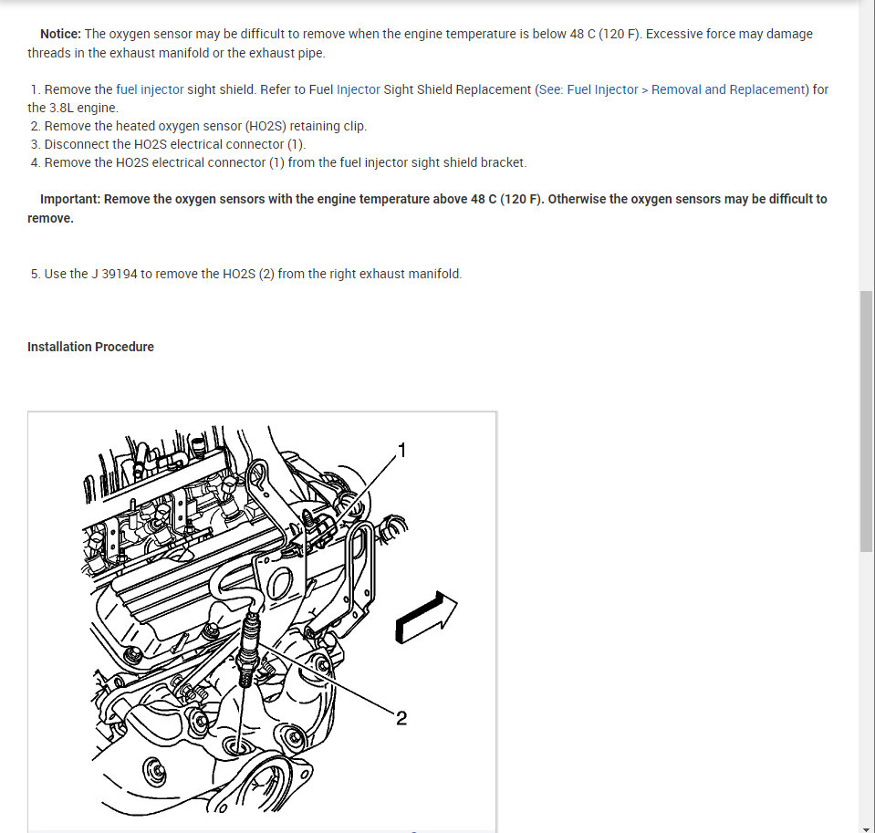

I need to change the bank 1 sensor 1 oxygen sensor can you help me?
2008 PONTIAC GRAND PRIX
19,587 MILES • 6 CYL • 2WD • AUTOMATIC
TRAVIS12
Can you help me change the oxygen sensor out please?
Feb 5, 2018 at 12:42 PM

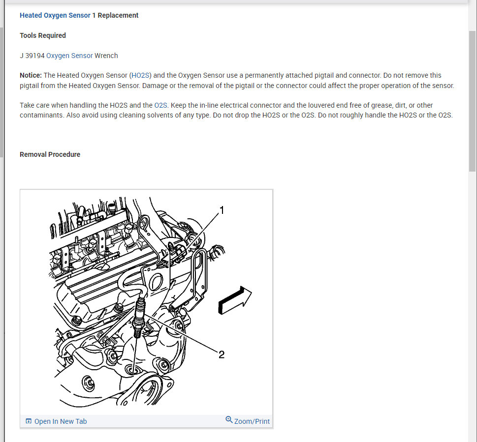

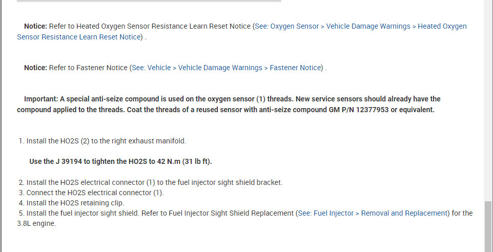

I am attaching the guides below that will help with step by step instructions that will help with this. Also, there is a guide on testing o2 sensors in case you need that as well.
https://www.2carpros.com/articles/how-to-replace-an-oxygen-sensor
https://www.2carpros.com/articles/how-to-test-an-oxygen-sensor-02-sensor
Below is the process from the manual on the o2 sensor replacement process.
Please run through this material and let us know if you have other questions. Thanks
