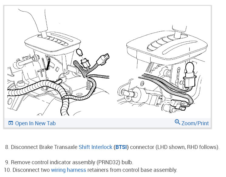

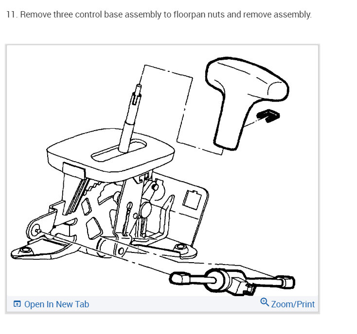

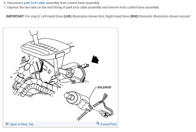

It sounds like the shift cable needs to be replaced. here are diagrams and instructions to do so. Check out the diagrams (below). Please let us know what you find.
