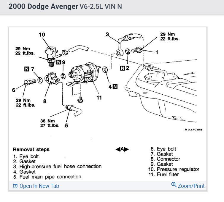

Ken. I changed plugs and wires. Was not the solution. What do you think about the vehicle speed sensor casing the problem?
Dec 20, 2018 at 5:43 PM
  • 55,684 POSTS

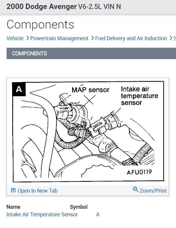

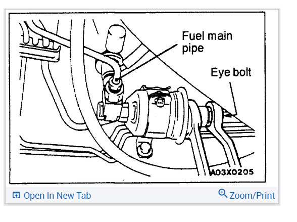

It would through a code if the sensor was causing problems. It sounds like the MAP or clogged fuel filter. If the MAP becomes weak it will give a false reading to the computer without setting a code. Here are the locations for both below with a guide to walk you through the filter change:
https://www.2carpros.com/articles/how-to-change-a-fuel-filter

DODGEMAN58
  • 6 POSTS
Thanks Ken. Will change both and let you know.
