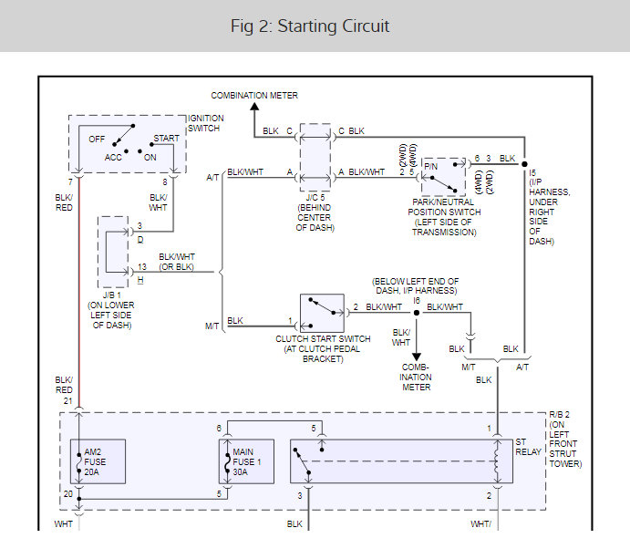

Not turning over
1994 TOYOTA RAV4
160,000 MILES • 4 CYL • 4WD • MANUAL
MWELLS
Brand new alternator.
Brand new ignition switch.
Brand new battery.
Still not starting. I just hear a click.
Sep 20, 2019 at 9:06 PM
SCGRANTURISMO
  • 4,897 POSTS

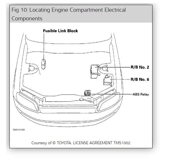

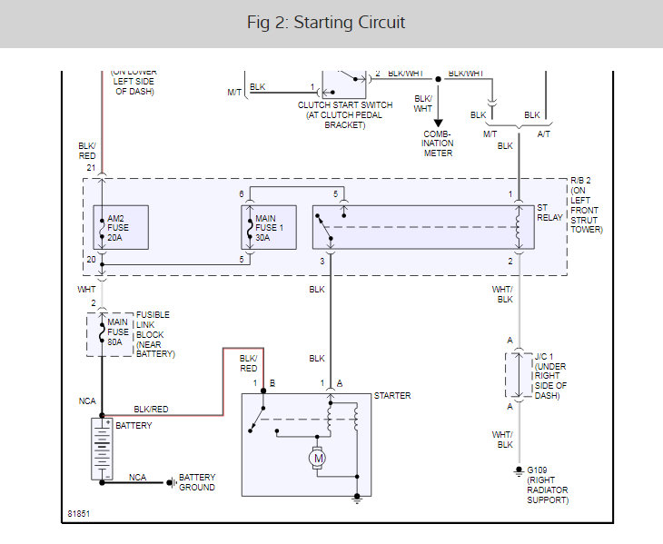

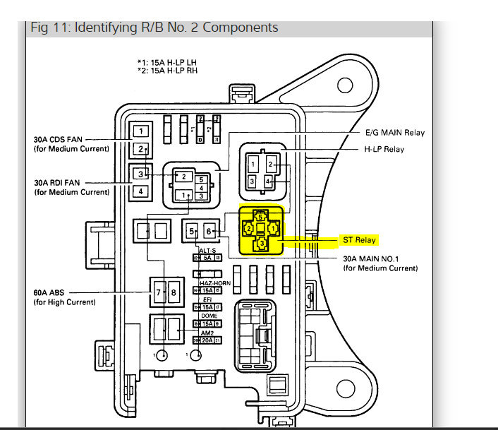

This could be a problem with the Starter Relay which is located in the R/B No. 2 Fuse Box in the engine compartment. I have included a wiring diagram of your vehicle's Starting Circuit, as well as a diagram of the location and layout of R/B no. 2 Fuse Box in the diagrams down below. Here is a link explaining how to test a relay:
Please go through these guides and let us know what you find out. We can proceed from there, if needed.
