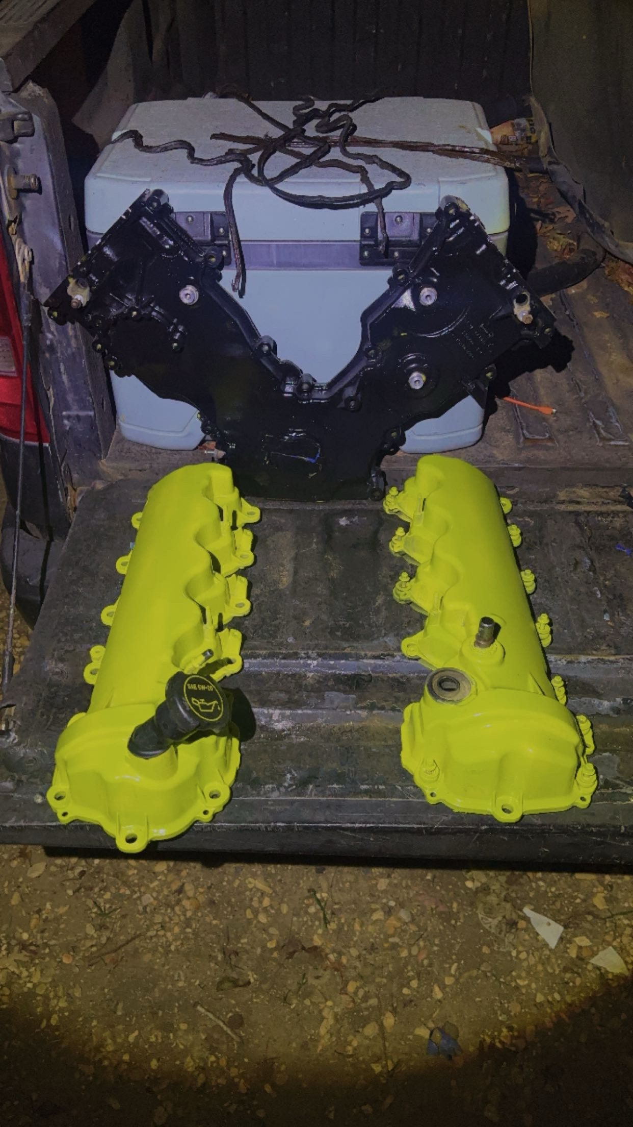

Mr Ken!!! I’m almost done with this timing and cam job!!!!!!! I’m installing the new roller followers today!!!! Sorry it’s taken such a long time to respond, I’ve had to save a little money each week to buy a few parts at a time!!!!! Only thing left to buy is oil filter and oil!!!!!! I am so grateful for your videos!!!!!!! I wouldn’t have been able to complete this job without them!!!!! You don’t know how much you’ve helped people like me that’s in a tough cookie and trying to fix things themselves!!!! You truly are a blessing when it comes to mechanics lol!!!!

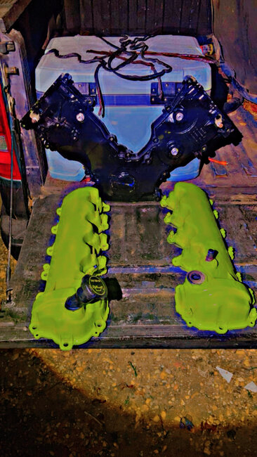

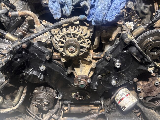

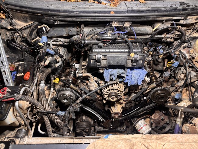

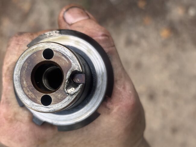

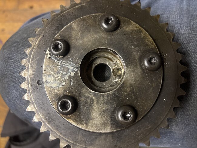

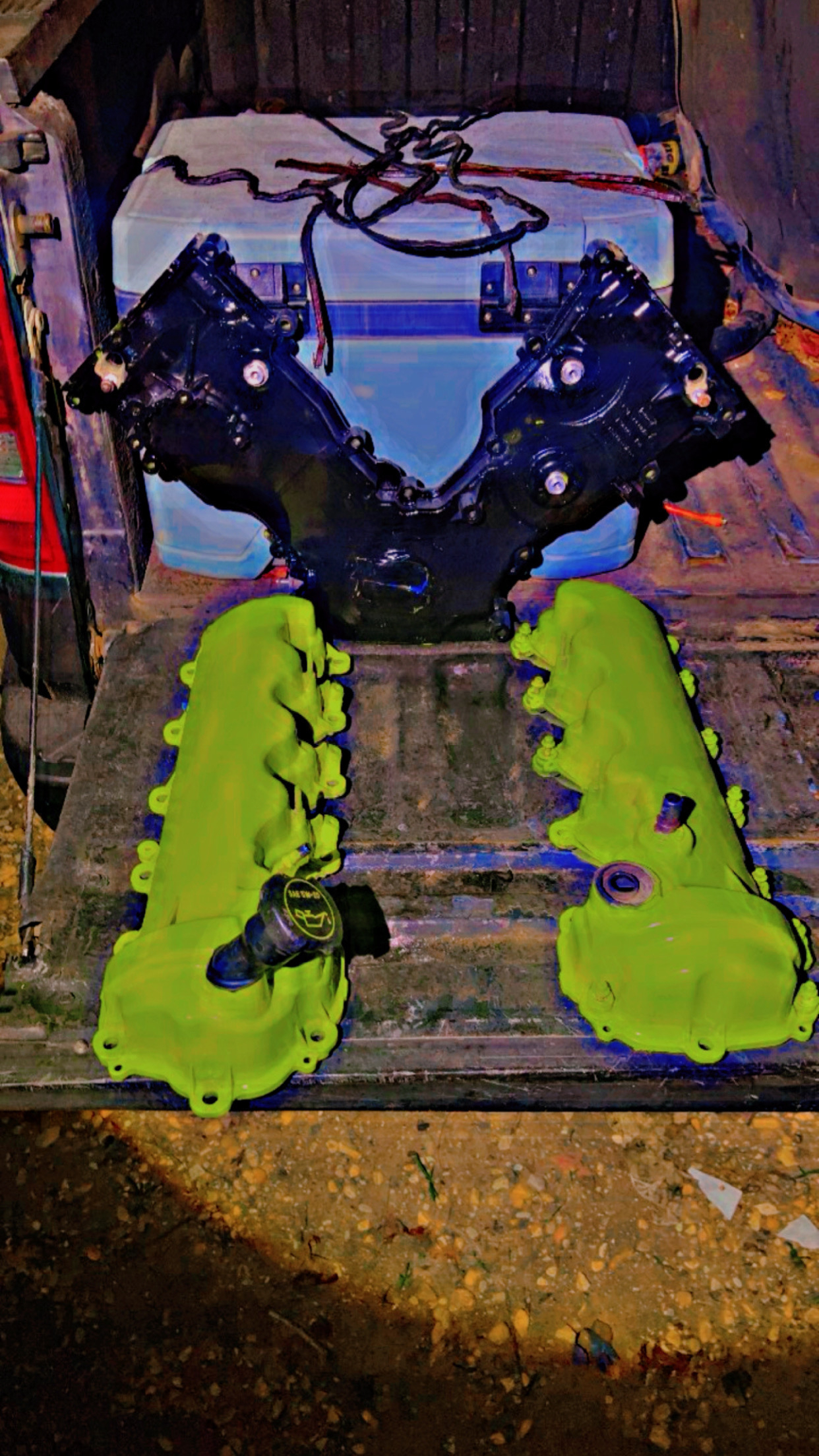

I attached a few photos from this journey, the first one was my passenger side cam shaft, not sure why or how it happened yea just my luck lol. The next 2 are my amazing shade tree mechanic paint job on my front cover and valve covers!!!! I loved the ford blue ones you had butttt my favorite colors are black and lime green so I figured why not give it a shot!!!!! The fourth photo is the night I got my chains, guides and tensioner on and timed. The fifth is my nicely painted front cover finally installed and the last photo is what was left of my old phaser, as you can see, that dial pin that supposed to be there was no longer there. And the three pins that held the front part, they were sheared
off also!!!!! But like I said before, none of this was possible without your videos!!!! I will be back soon with an update and when I crank it, you’ll see a video!!!!! Can’t wait!!!! Thanks Mr Ken for all your help!!!!!

Yep, it looks like the camshaft actuator was loose and that is why it wallered out the pin holes. Did you replace the damaged camshaft? I like the colors BTW and thanks for those kinds words, we try to help ;)
