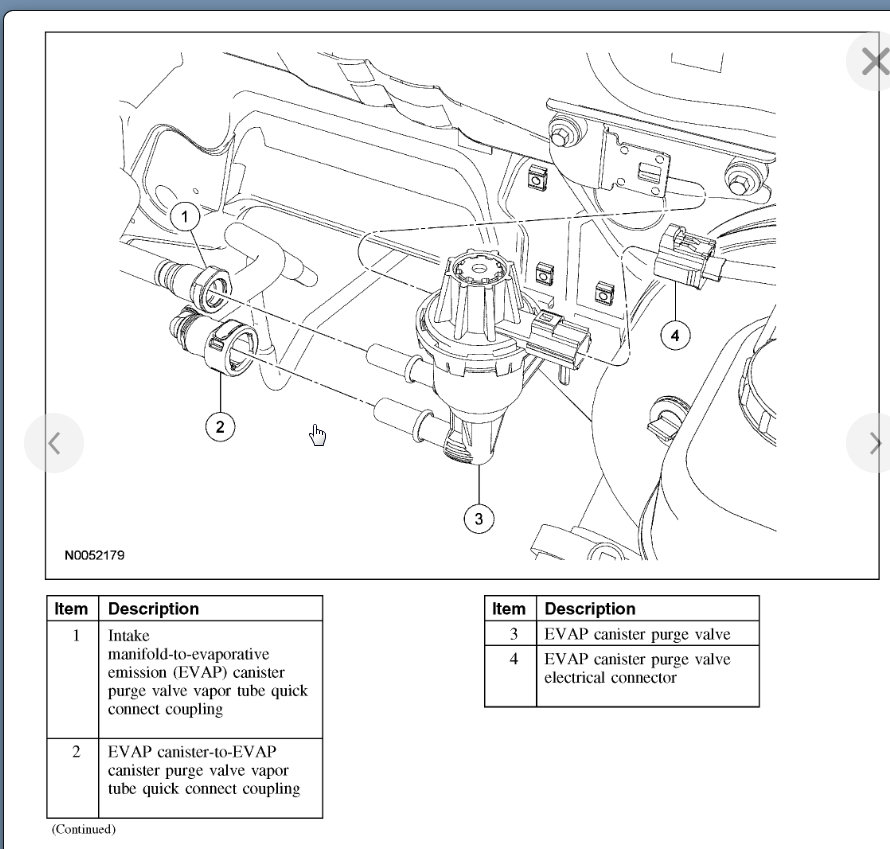

The vehicle listed above we picked up to tow our camper has an intermittent sputter. Never while accelerating or driving. We first had it happen in line at a sporting event it started a rough idle and I had to put it in neutral and rev it. It has happen periodically in drive thru lines. It is always when at idle in a stop and go sort of situation. I say always but I mean that is the only time it happens and it happens intermittently. The vehicle has never thrown a code. Thoughts?
Sep 13, 2020 at 6:22 AM (Merged)

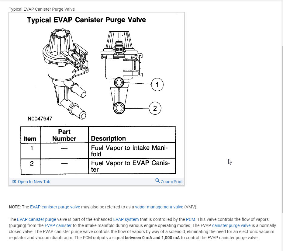

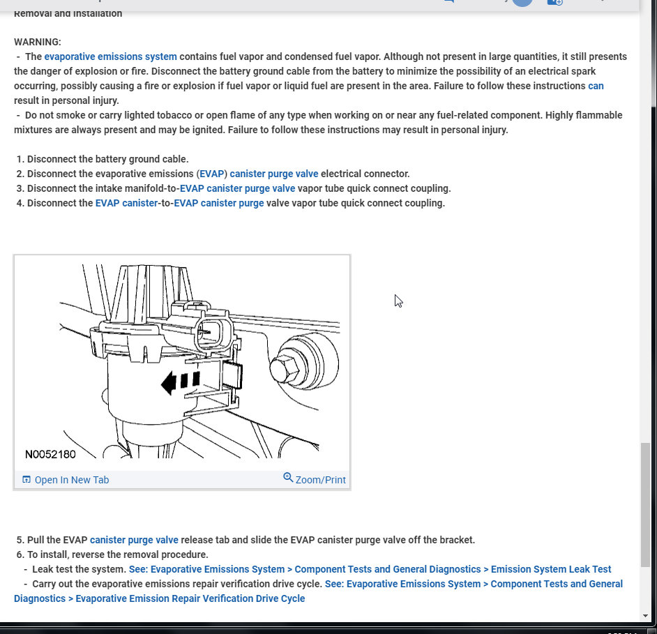

I suspect this is the purge valve that is sticking as it would explain why it is intermittent. Basically the engine purges during idle times and if reving the engine smooths it out and until it stops would fit as well because you are basically allowing more air in to even out the air/fuel ratio.

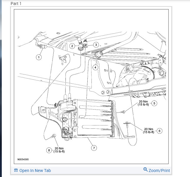

I would remove the purge and see if there is carbon in build up in it. Basically what happens is if you top off the fuel tank, fill the tank with the engine running, or the charcoal canister gets fuel in it other ways, it breaks down the charcoal. This then causes the charcoal get get into the purge valve and cause it to stick. Once this happens, there are fuel vapor coming into the engine when the PCM doesn't expect it making it too rich or even too lean if it is stuck closed and the engine will run rough or stumble.
Let me know if you have questions. Thanks

So, unfortunately, this was not the issue. I replaced the part and no change. To add more context. The truck never has a problem while driving. However, this weekend in pulling a 6,000 pound camper the truck went through an entire tank of gas in less than a 3 hour drive on the highway. Anyway, it never does it while driving, it never does it in park. It only does it (occasionally) when in drive in a stop and go sort of a situation and in reverse, say when attempting to back in the camper or something. The camper is not the cause of the problem as it was doing it before we even owned the camper.
Okay. Then we need to use a scan tool at this point to check the fuel trims from the PCM. This will tell us if we have a rich condition which is what this sounds like. Clearly with the added info of poor fuel economy will point us towards it just dumping too much fuel. This could be an o2 sensor issue or faulty injectors. The fact that it is not constant I suspect a sensor issue but we need to start with finding out if the engine is running rich.
