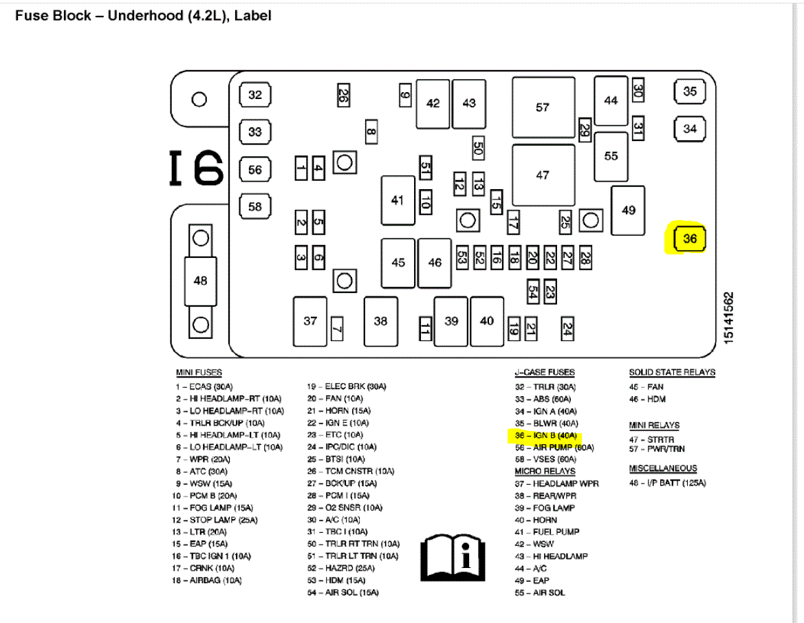

Not starting and key will not come out of ignition
2006 CHEVROLET TRAILBLAZER
229,000 MILES • 4.2L • V6 • 4WD • AUTOMATIC
BLAZER2006
Starter was making clicking noise I tightened the bolt and now it will not start, and my key is stuck in ignition. Lights are bright and working.
Nov 9, 2021 at 2:22 PM
  • 110,240 POSTS
It sounds like a failed fuse. The ignition B fuse in the under-hood fuse box is where I would start. When checking the fuse, not only is it important to confirm the fuse is good, but also you should check to confirm it is receiving power.
Here is a link that you may find helpful:
If you look below, I highlighted the fuse I'm questioning at this point. Please check it and let me know what you find.
See pic below.
