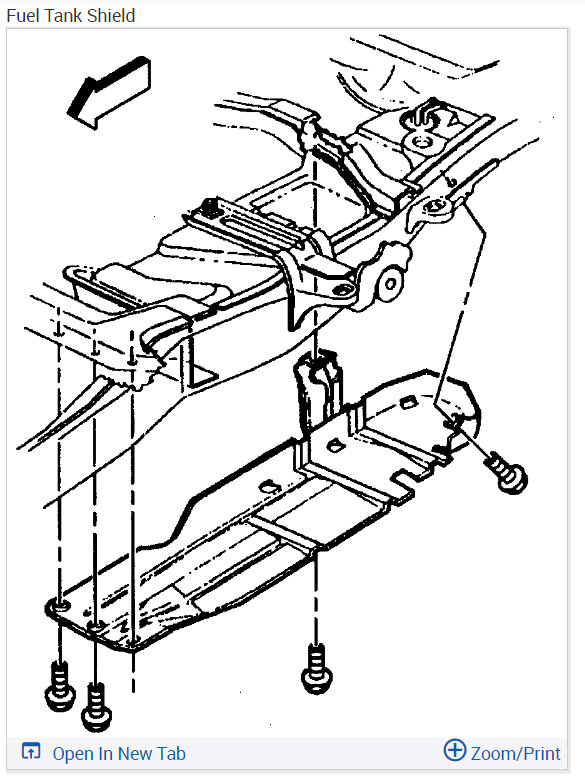

It will start only if I'm pouring gas into the throttle body but shuts off as soon as that gas is burned. it was running fine then suddenly just shut off. Is the problem with the fuel pump? It is getting fuel to the top of the motor. Please help me.
Aug 24, 2024 at 1:38 AM
  • 54,832 POSTS

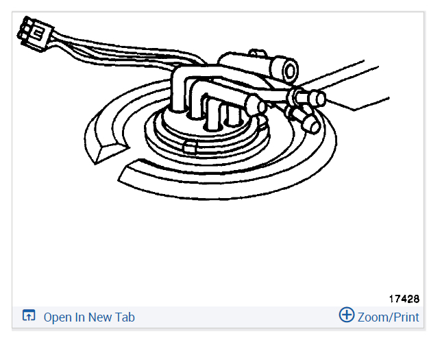

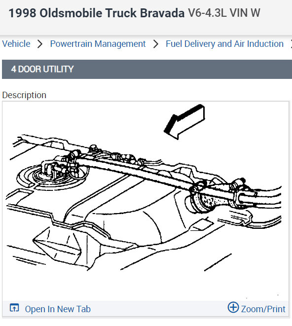

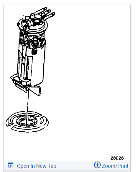

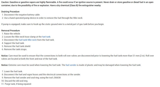

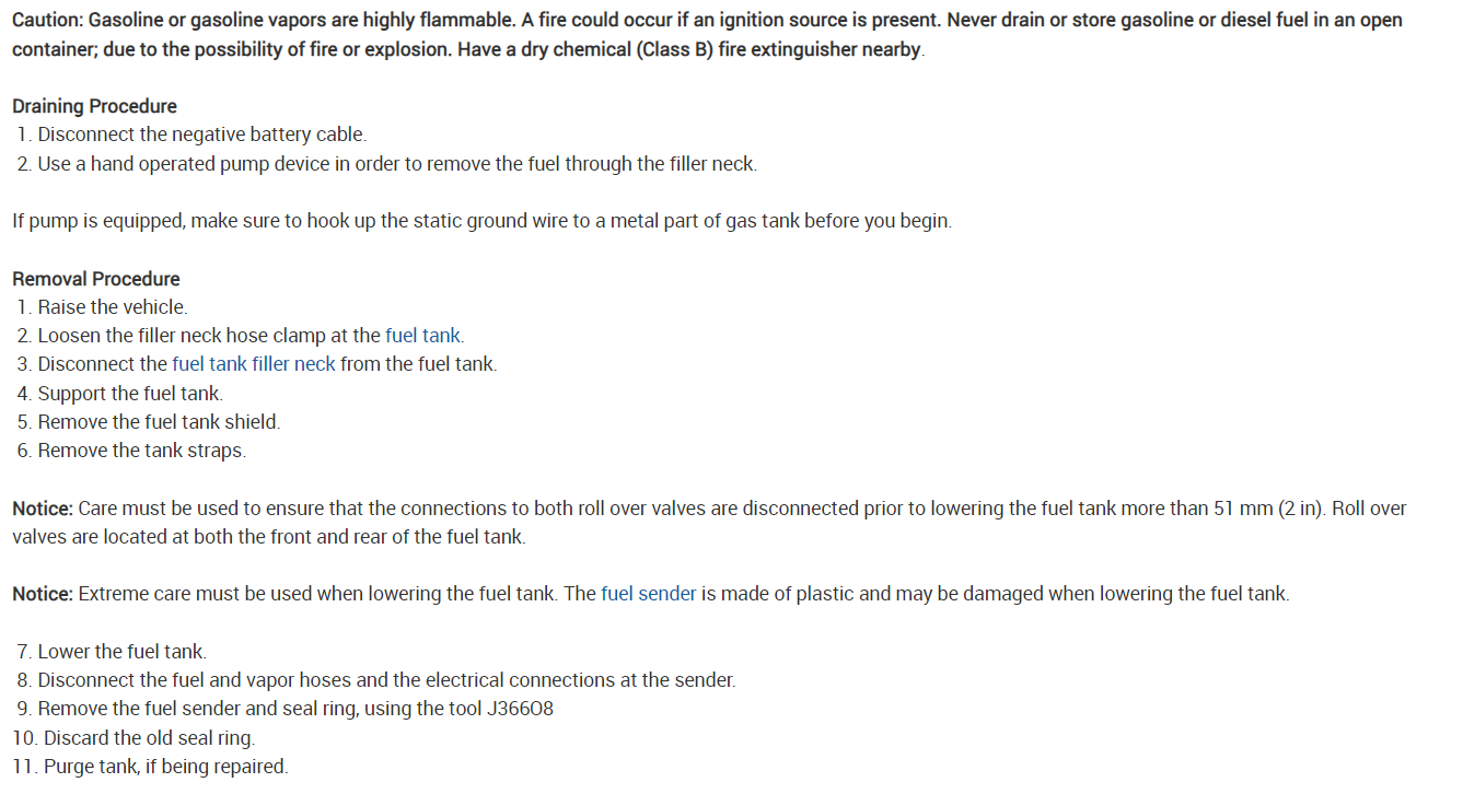

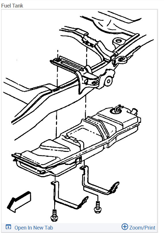

Yep, the fuel pumps go out in these cars, to be sure can you turn the key on without cranking the engine over to see if you hear the fuel pump run in the tank for about 5 seconds? You can be sure if you break into the gas tank harness to test the grey wire of power when cranking. If it has power and you don't hear the fuel pump it is bad and needs to be replaced, here is how:
Do not remove the fuel tank with gas in it, here is how to drain the fuel out, do not have open flames:
https://youtu.be/Q5MH2gnyFH0?si=kp0VS37BDELXicAr
Check out the images (below). Please upload pictures or videos in your response of any problems so we can see what to help you with.
