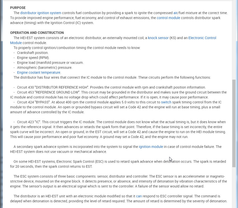

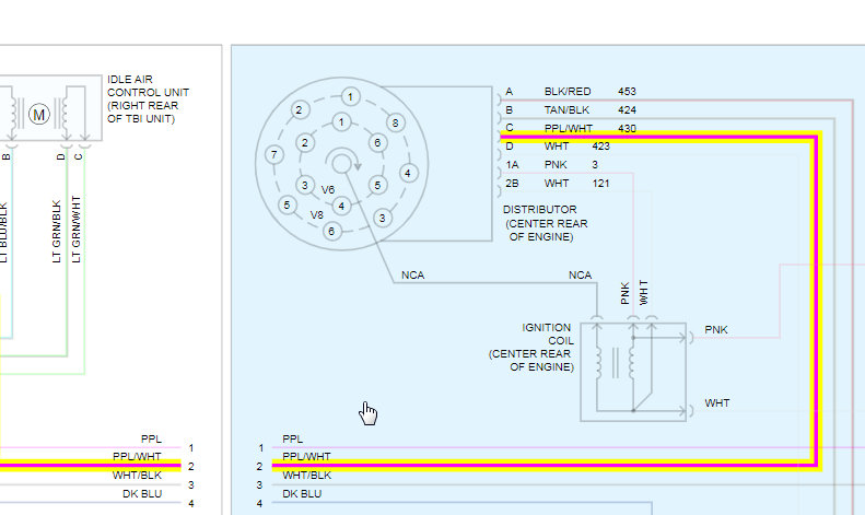

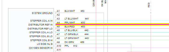

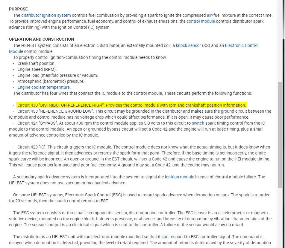

Your vehicle does not actually have a crank sensor. It uses the distributor to determine crank position and sends this info to the ECM on the distributor ref hi circuit. Circuit 430. Take a look at the info I attached to see more detail.

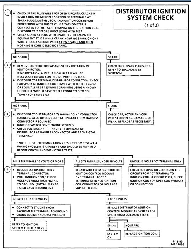

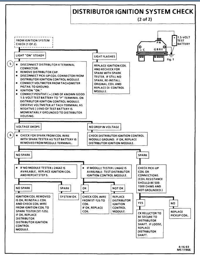

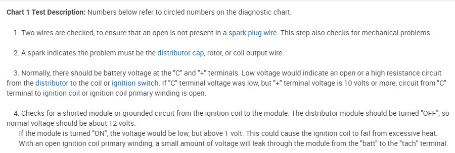

Okay. That is good info. We need to go after the ignition issue because without that, you can all the fuel in the world and it still will not start. Once we get spark, we can readdress fuel if it still doesn't start.

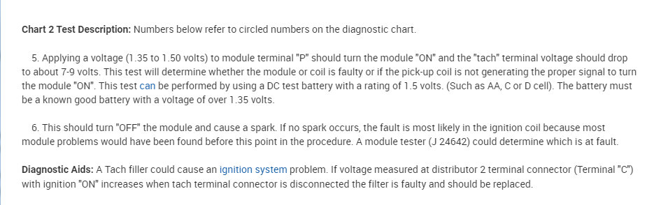

I attached the ignition system testing. We need to run through all of this and see where it leads. Some of the parts you have already replaced but let's just go step by step and see where we end up. Thanks

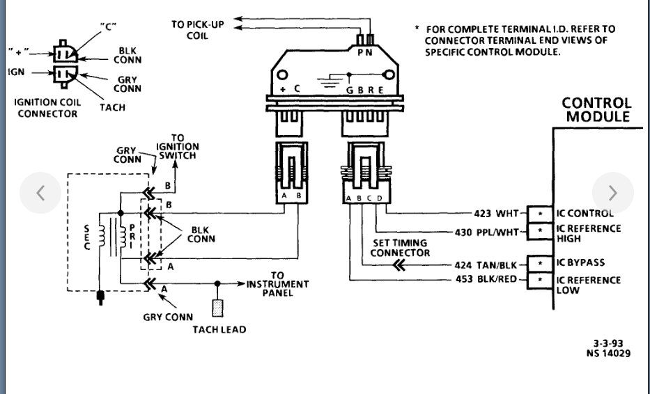

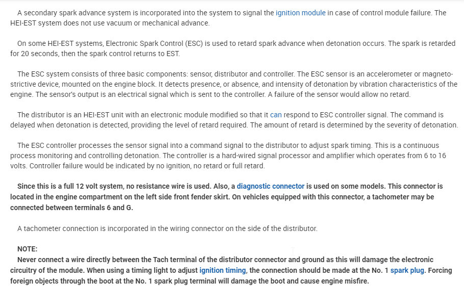

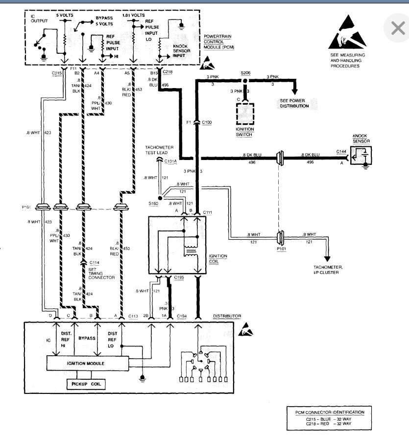

Okay. If there is no spark at the coil we need to back track in the system. I attached the info on how it works. However, we need to go back to the PCM and see if we have signal going to the coil. Also, the ignition module and pick up. I suspect your issue is in these parts because if when it happens when it rains that points to a weak spark which would be the pick up most likely.
