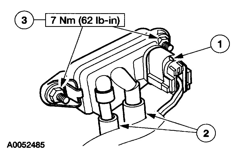

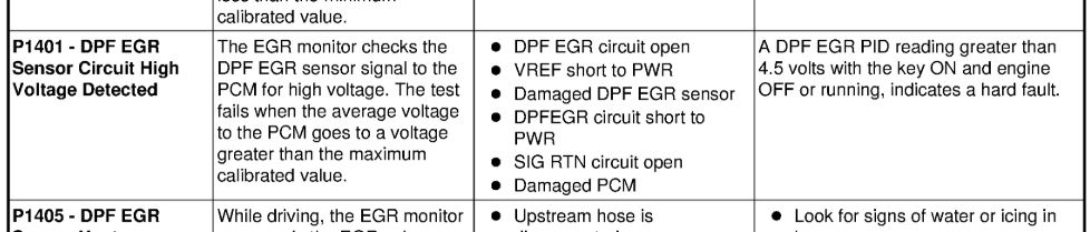

That code correlates with a P1401, EGR circuit. Basically, too much power is being sent to the EGR (greater than 4.5v.)
Do me a favor, disconnect the EGR sensor connection and see what happens.

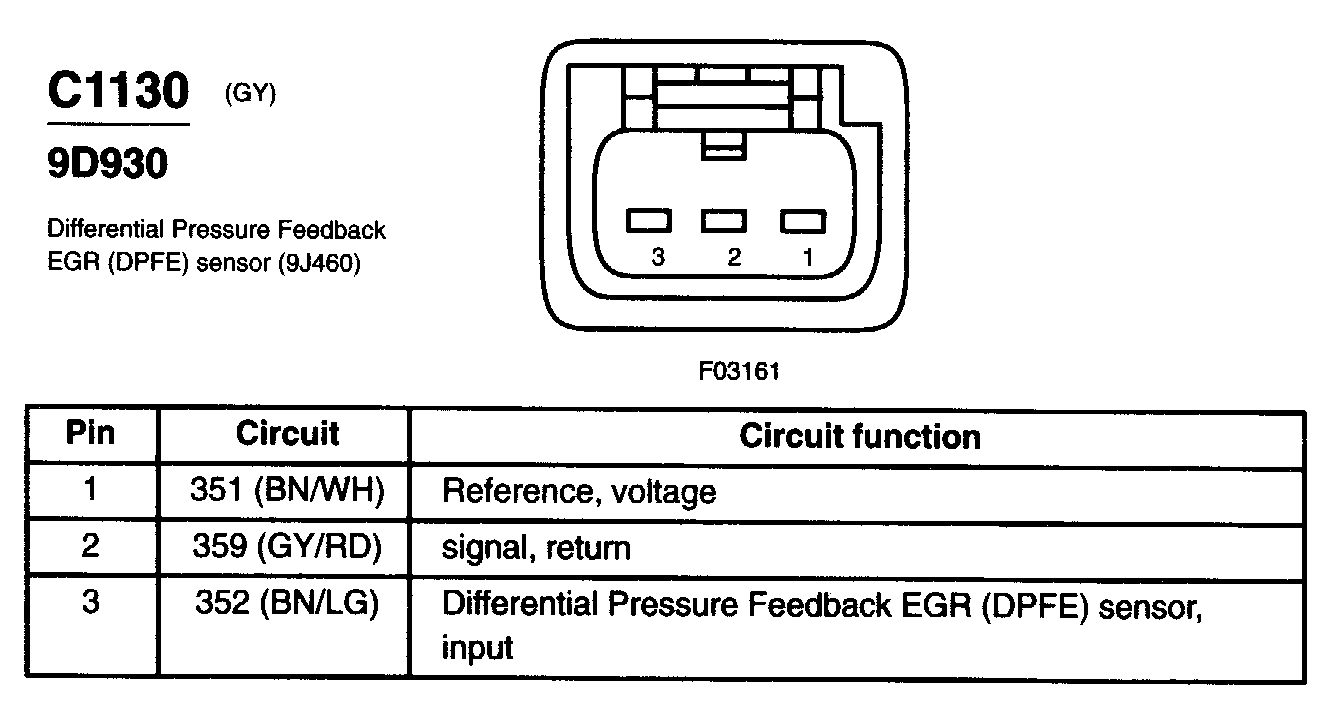

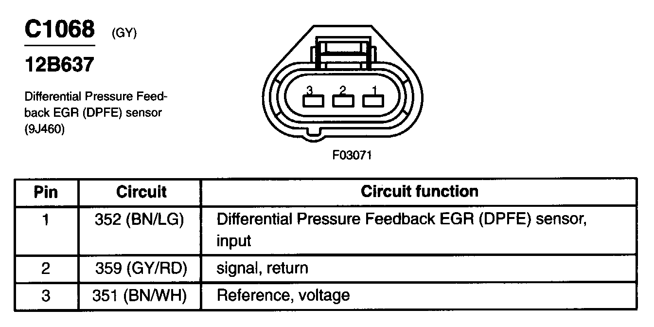

If you look at picture 1, I copied possible causes. I need to know a couple things before I proceed. First, I need the 8th digit of the VIN to confirm which engine you have. There are single overhead cams and dual overhead cams. If you look at pictures 2 and 3, they show the connector for the sensor. Which engine you have will determine what pin to test and what it should be.
If you disconnect the sensor, it should drop voltage and allow the engine to start, but it may not run too good. So, let me know what happens. Also, confirm the vacuum lines going to it are not damaged. That can cause issues as well.

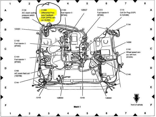

The sensor should be on the passenger side under the hood. I attached pictures of it and location, picture 4 and 5.
