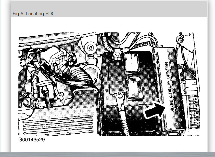

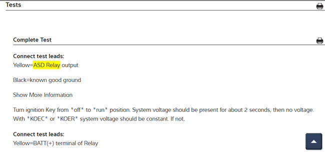

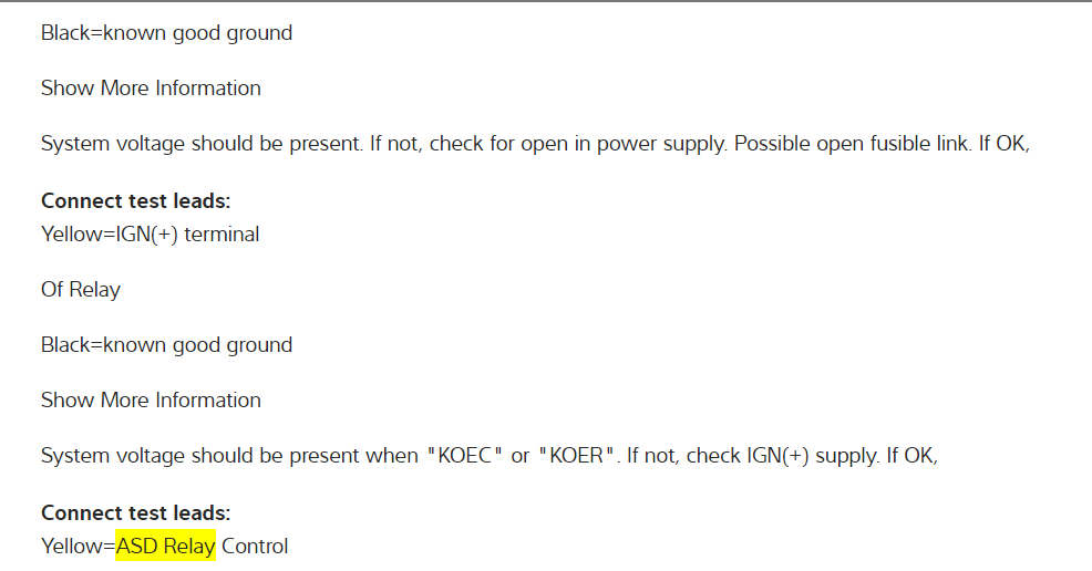

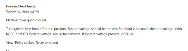

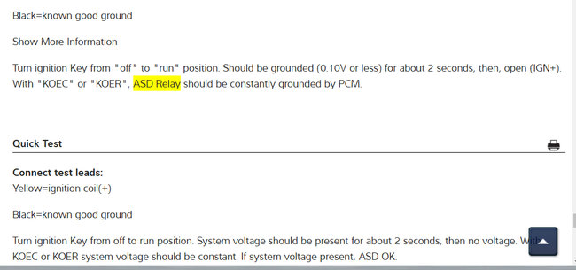

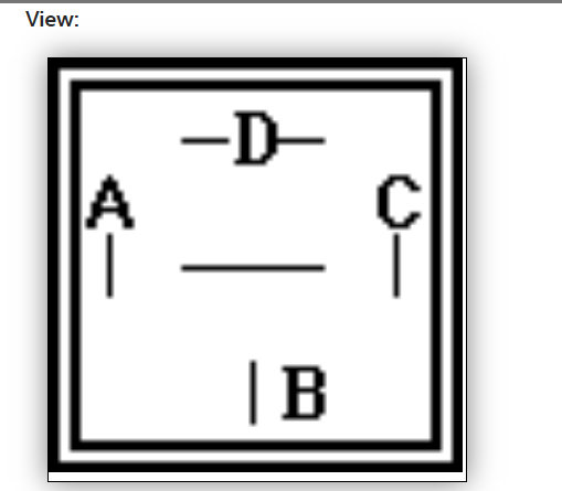

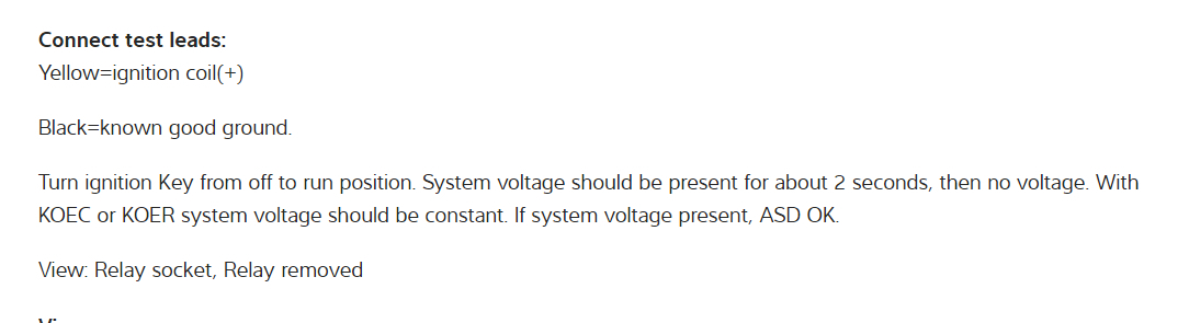

I was driving and it all of a sudden quit running. Battery is good and fuel pump is working. Replaced coil pack and crankshaft. I don't have spark. I'm stuck with a van that does not run and I am out of town and have no money. Please help.
Apr 28, 2019 at 10:54 AM
SCGRANTURISMO
  • 4,897 POSTS

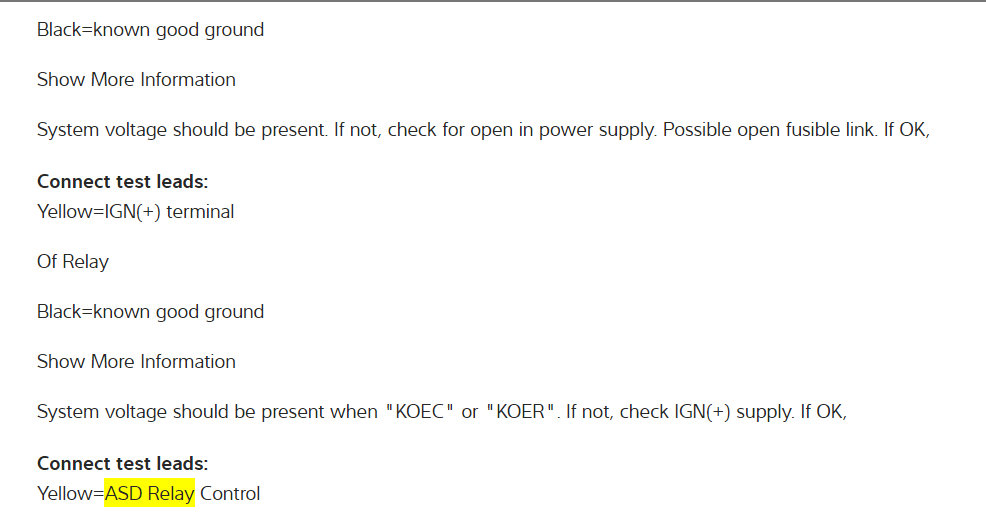

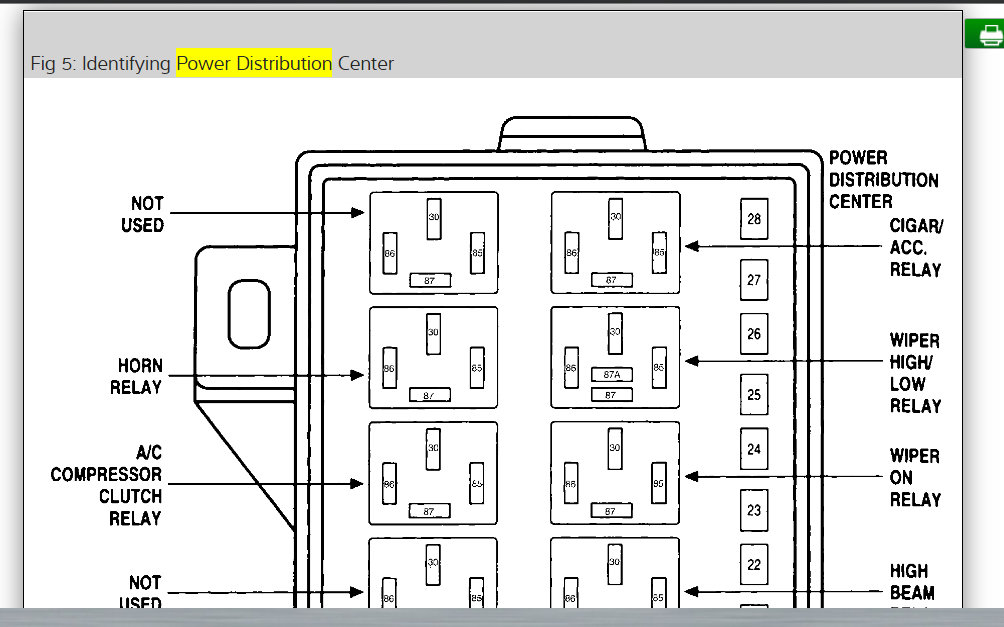

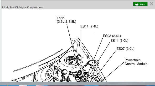

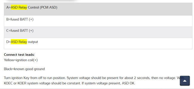

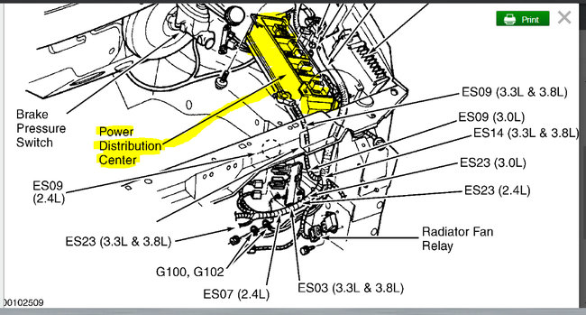

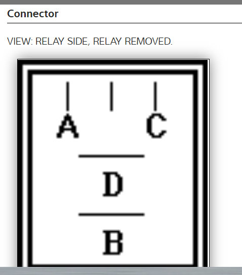

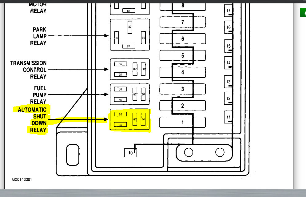

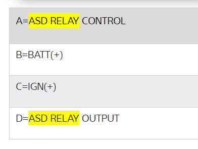

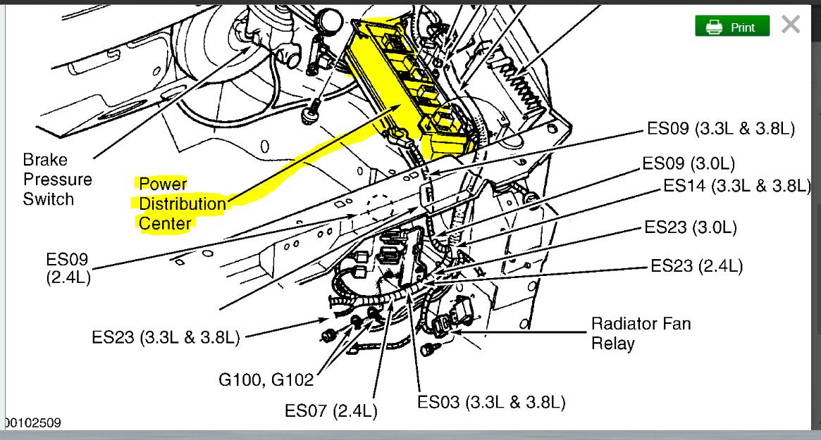

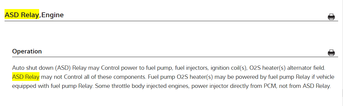

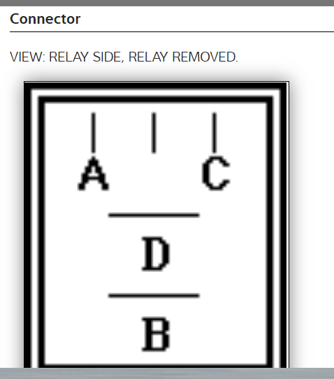

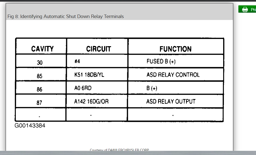

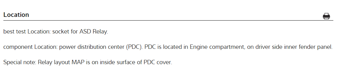

This could be a problem with your Automatic Shutdown Relay (ASD). It is located in the Power Distribution Center (PDC) in your vehicle's engine compartment by the battery. It controls power to the coils, which in turn provide electricity to the spark plugs, making them spark. In the diagrams down below I have included all the information that you will need to test and if necessary replace the ASD relay. Please get back to us with what you are able to find out.
This guide can help fix it as well
https://www.2carpros.com/articles/engine-stalls
Check out the diagrams (Below). Please let us know what you find. We are interested to see what it is.

A lot of times, it is the ASD (Auto Shutdown) relay. Try swapping the relay with another, and see what happens.
If that doesn't help, you have to test a few sensors: ECT Engine Coolant Temperature, TP Throttle Position, CKP Crankshaft Position and CMP Camshaft Position sensors.
