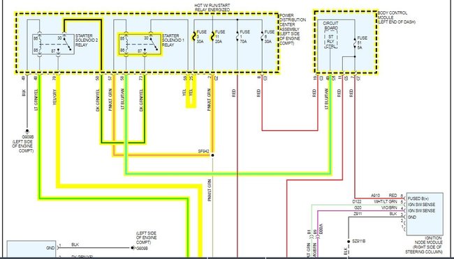

Tried to start my car, it didn't turn over or even make a noise. it is giving me a lot of warnings. like; service power steering, airbags, brake system, check fuel cap. pretty much everything. also i tried to turn my radio on and it says the key must be in the run position. and it is in the run position. i checked some fuses and they all seem fine. i'm stumped.

Okay, I attached a wiring diagram for you to view. Check the highlighted fuses. If they are good we will need to do some testing. This system has 2 relays for the starting system.

Well all the fuses look good. the bigger black ones the relays I believe I am unsure about and don't know how to test them.
Feb 21, 2020 at 4:45 AM
You need to test for power at the fuses I highlighted. This is not a visual test, it is a power test with a test light.
We will need to test for powers at the relay.

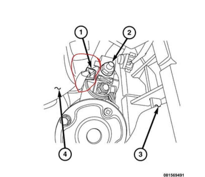

Okay, I need you to go to the starter motor. There is a big wire on the solenoid from the battery and a small wire as well. Test for power on the small wire with the key in the start position.

Not sure which one.
Feb 21, 2020 at 7:45 AM
Picture attached.

Sorry, but that picture really didn't help me.

The starter is down where the engine and transmission come together. It is at the front side of the motor about halfway down.
