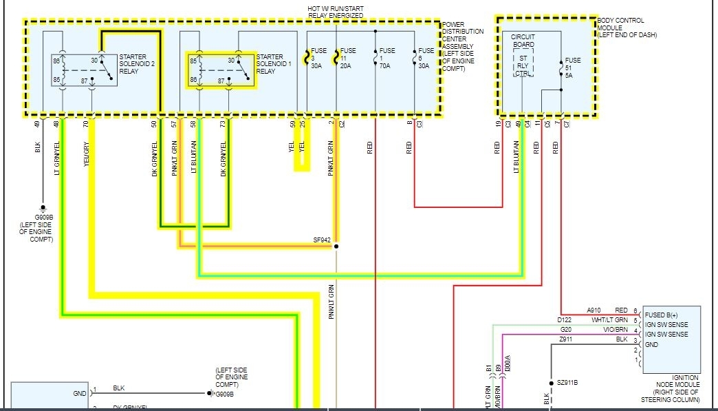

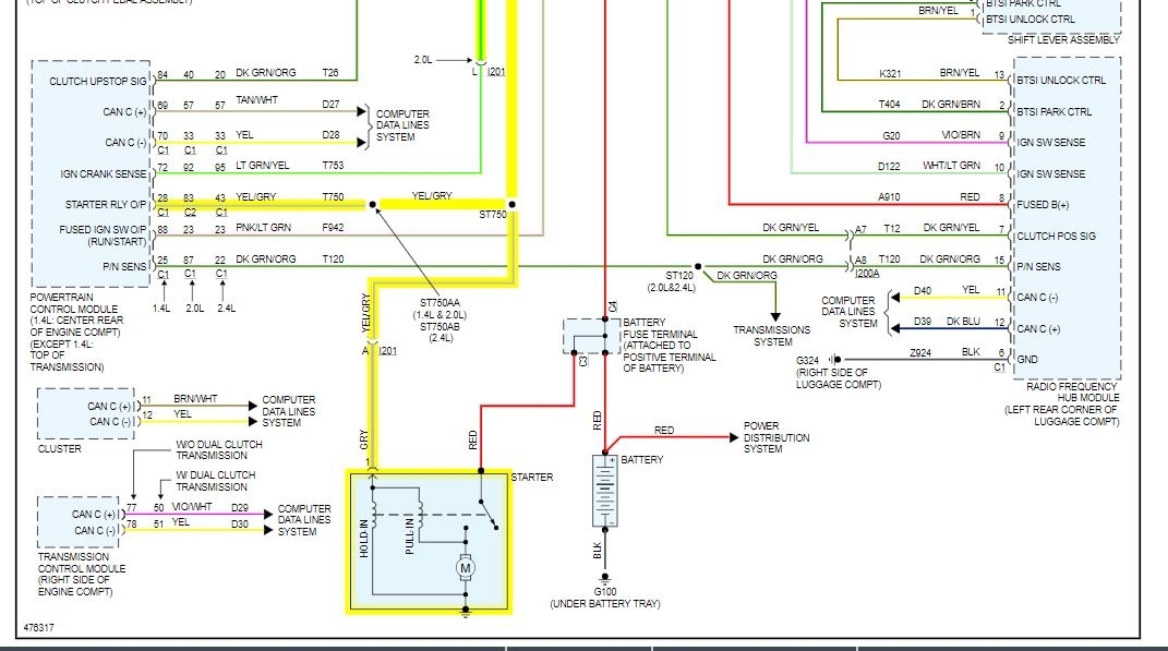

Okay, I attached a wiring diagram for you to view. Check the highlighted fuses. If they are good we will need to do some testing. This system has 2 relays for the starting system.
Friday, February 21st, 2020 AT 12:30 PM
B
  • 16 POSTS
Well all the fuses look good. The bigger black ones the relays I believe I am unsure about and don't know how to test them.
Friday, February 21st, 2020 AT 12:45 PM
  • 52,797 POSTS
You need to test for power at the fuses I highlighted. This is not a visual test, it is a power test with a test light.
We will need to test for powers at the relay.
Friday, February 21st, 2020 AT 12:51 PM

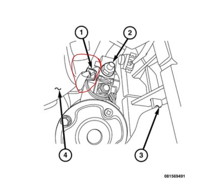

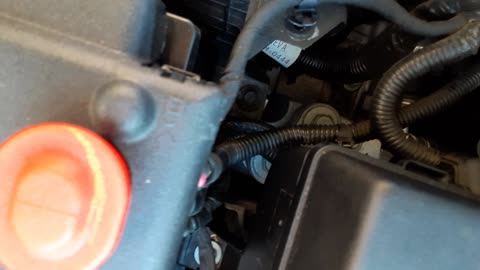

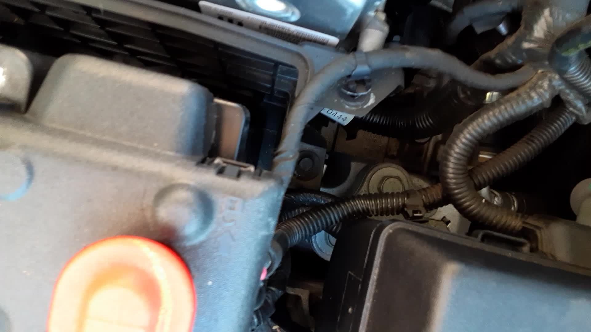

Okay, I need you to go to the starter motor. There is a big wire on the solenoid from the battery and a small wire as well. Test for power on the small wire with the key in the start position.
Friday, February 21st, 2020 AT 3:31 PM
B
  • 16 POSTS
Not sure which one.
Friday, February 21st, 2020 AT 3:45 PM
  • 52,797 POSTS
Picture attached.
Friday, February 21st, 2020 AT 3:53 PM
B
  • 16 POSTS
Sorry, but that picture really didn't help me.
Friday, February 21st, 2020 AT 3:56 PM
  • 52,797 POSTS
The starter is down where the engine and transmission come together. It is at the front side of the motor about halfway down.
