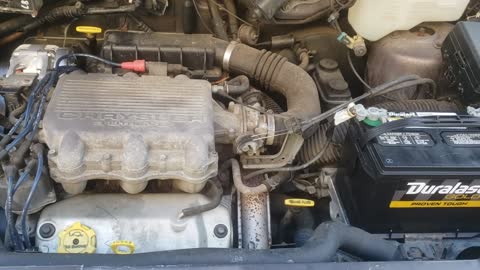

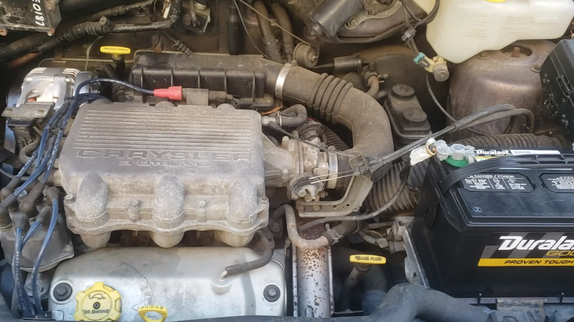

Not starting, could it be the fuel pump?
110,000 MILES • 3.0L • 2WD • AUTOMATIC
LADYAMS
When we try to turn the car over, it makes a single deep clunk sound. We just replaced the alternator and battery.
Jun 13, 2021 at 6:12 AM
Good afternoon,
Do you mean the starter engages but the engine will not turn? If that is the case, I would remove the spark plugs and try again. If there is liquid in the cylinders it will not turn.
If it still does not turn, then the engine is locked up from an internal failure.
Can you upload a video of it trying to start?
Jun 13, 2021 at 6:56 AM
LADYAMS
I don't think it's getting to the starter engaging. Thanks so much for your help!
Jun 13, 2021 at 10:03 AM
Thank you. See if you can turn the engine by hand.
It sounds like the starter is engaging but the motor is not turning.
