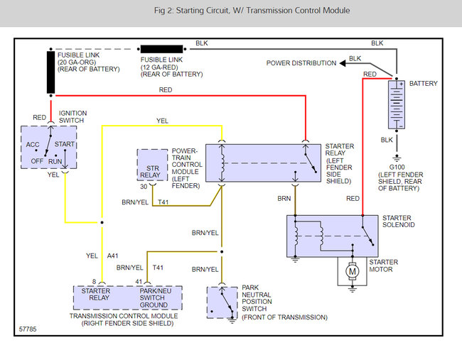

Hi my name is rich my car wont start. Theres a clicking sound coming from starter relay but.not the.actual starter. The starter makes no sounds. So I replaced the battery thinking not enough power. But nothing changed. So then I took a piece of wire and jumped the starter relay and you can hear the starter motor spinning. So could it be the relay and the starter solenoid is bad. Any thoughts would be much appreciated thanks in advance

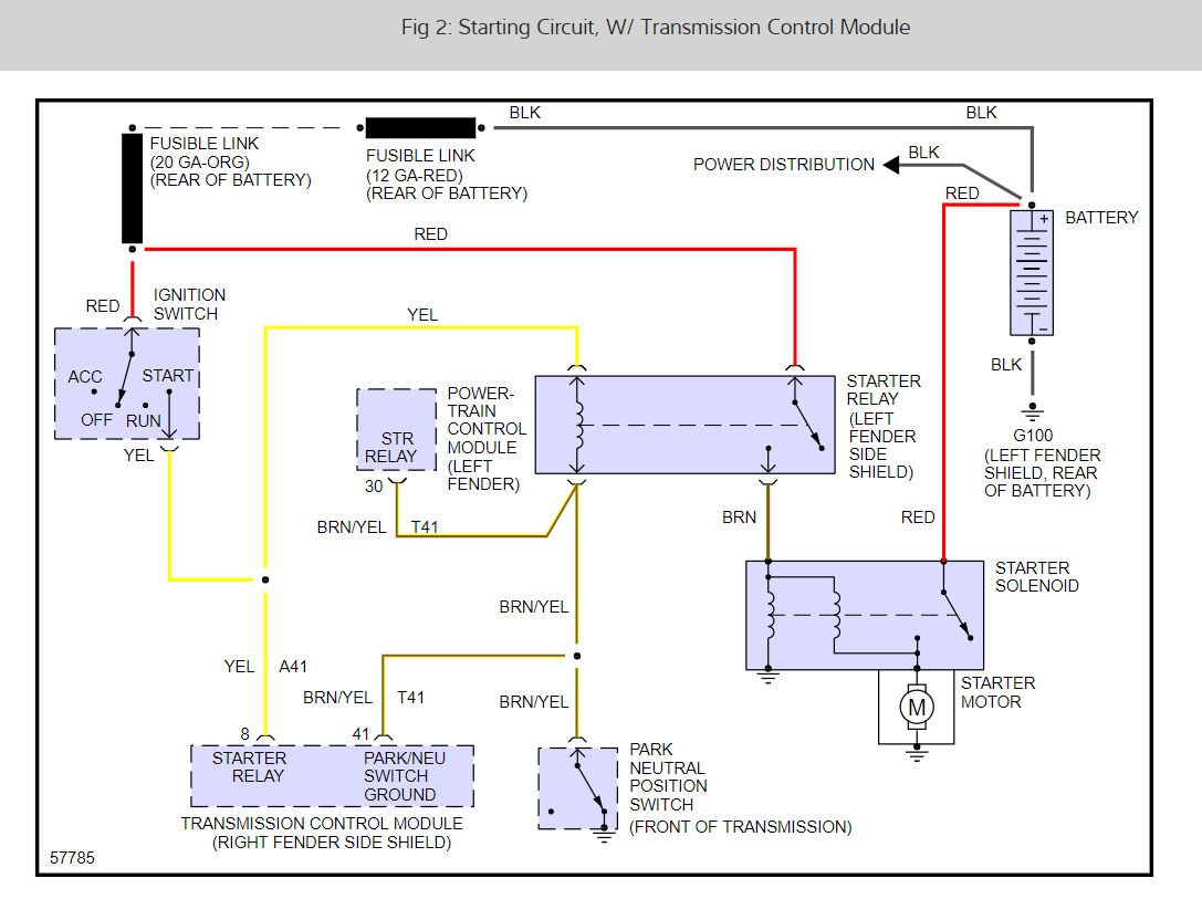

First let me be sure we're talking about the right parts. The starter relay is in the under-hood fuse box and is rather hard to hear. The starter solenoid is built into the starter and commonly makes a single, rather loud clunk, but the starter wont spin the engine. Where exactly did you jump, and if the starter was spinning, was it cranking the engine? It sounds like the neutral safety switch may have failed here it the starter wiring diagrams so you can see how the system works.
See where you are loosing power. Check out the diagrams (Below). Please let us know what you find. We are interested to see what it is.

Thanks for responding there are multiple relays under hood against fire wall on drivers side next to battery. When turning key. starter relay will make a click sound each time I move the key to start it. The relays on my car are little black boxes that looks like little electrical plugs but not like a fuse or fuse box i. I checked out the neutral safety and it was bad I got new one and BAM all fixed!

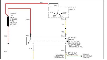

Hi, I have 1993 Plymouth Acclaim, I drove it to work the other day and it ran fine but when I got off work it wouldn't start. When I turn the key to start I get nothing. I have checked the battery,the relays, and the fuse links, they all seem good.

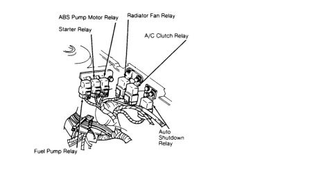

I'd have to be sure the battery has a full charge and all the connections are good. Did you try cranking in neutral? Check for voltage at the starter relay, when testing, make sure the tranny is in park or neutral and a functional e-brake is set. At the relay, red wire is hot/voltage all the time. Yellow wire goes hot with key in the crank position.
https://images.2carpros.com/forum/automotive_pictures/170934_acclaim_starter_wiring_1.jpg
https://images.2carpros.com/forum/automotive_pictures/170934_plymouth_acclaim_relay_1.jpg

Tested the relay, I get voltage to the yellow wire when I crank but the relay doesn't click. Tested a couple of the other relays they do the same.

The ground for the coil side of relay is through the neutral switch. No ground, the relay won't energize. If you use a jumper on the left side of relay picture between red wire and brown wire, the starter should crank. You don't have to use the key. If it still won't crank, have the starter tested. Some of the national brand autostores will test the starter for you. Yeah, you have to take it off and take it to them.
Any testing at the relay, make sure the tranny is in park or neutral and the e-brake is set. I got nothing else, have a good day.

I tried that and the starter cranks, I was thinking maybe ECM. Thankyou

I'm thinking issue with neutral switch?

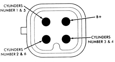

it sounds like there is a relay or the ecu is not working when hot but here is were the relay box is on your car, Under hood, driver side, front side of strut tower, mounted on fenderwell when it is not starting you should see a ignition relay in that box pull it and with volt ohm meter check for contonuity and see if yuour getting voltage to that relay put on 20 volt and see if your getting 12 volts if not it would be the ecu and when it gets hot it shuts down till cooled off the ecu is located Under hood, driver side, front side of strut tower, mounted on fenderwell and now that I think about it it could also be the ignition control module located Under hood, passenger side, upper engine area, end of intake manifold, mounted in distributor now try this test
https://images.2carpros.com/forum/automotive_pictures/52960_0900c1528005dec8_1.jpg
Fig. 1: Ignition coil terminal identification-3.0L Premier and Monaco engine If voltage is at near-battery voltage, and drops to zero after 1-2 seconds of cranking, refer to for diagnostic trouble codes and further testing. If voltage remains at near-battery voltage during the entire 5 seconds, turn the key OFF and remove the Single Board Engine Controller (SBEC) 60-way connector. Check the 60-way connector for any loose or pushed out terminals.
