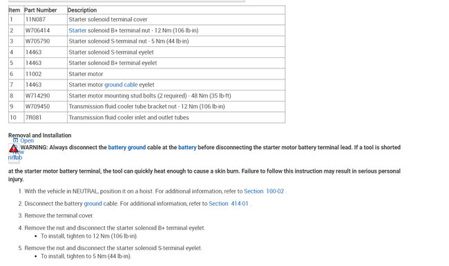

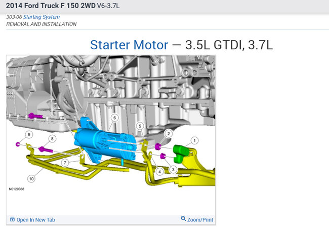

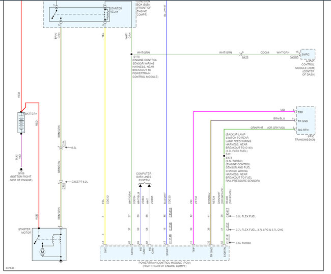

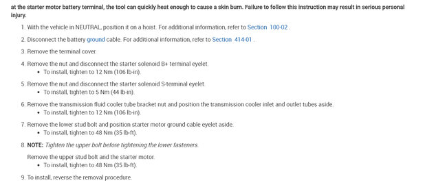

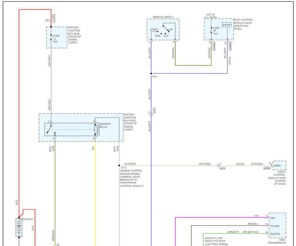

It sounds like the starter motor went bad, but to be sure this guide can help you test for power at the starter trigger wire:
Here are the starter wiring diagrams and how to change out the starter in case you need it. Let me know if the trigger wire is getting power. I would do a CAN scan as well; you can get a CAN scanner (Controller Area Network) which will work on most cars from Amazon.
