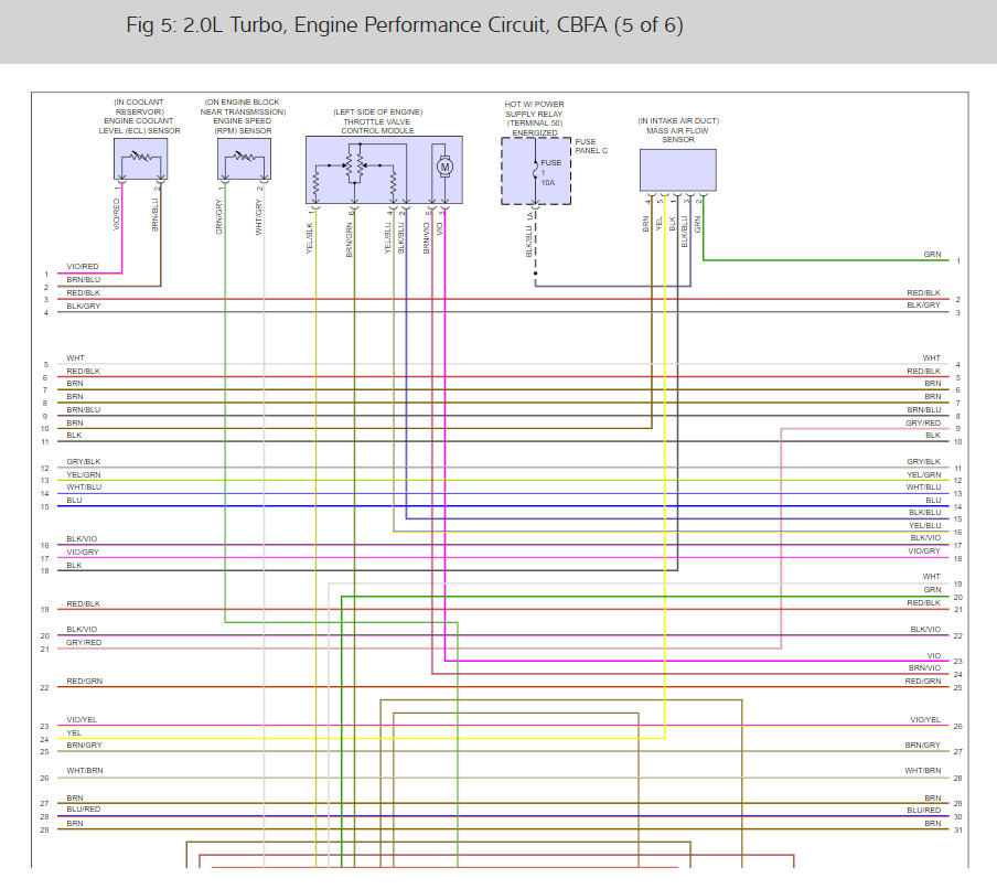

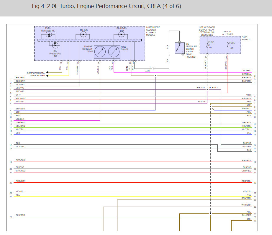

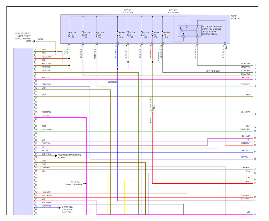

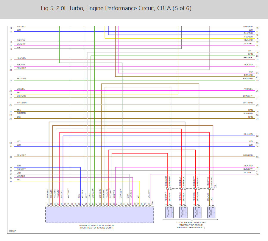

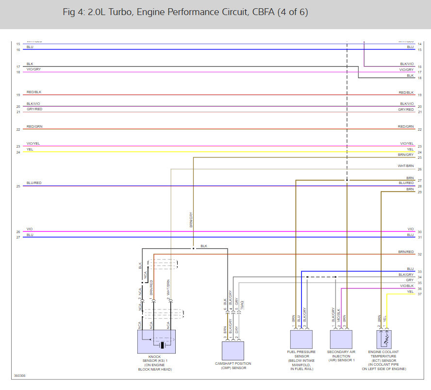

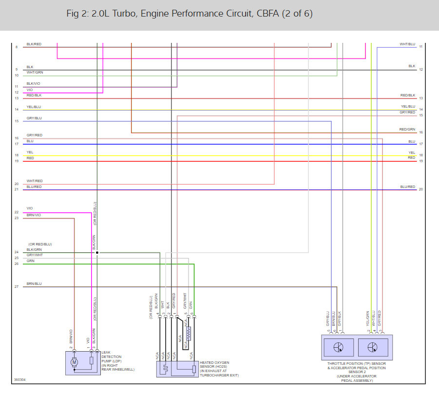

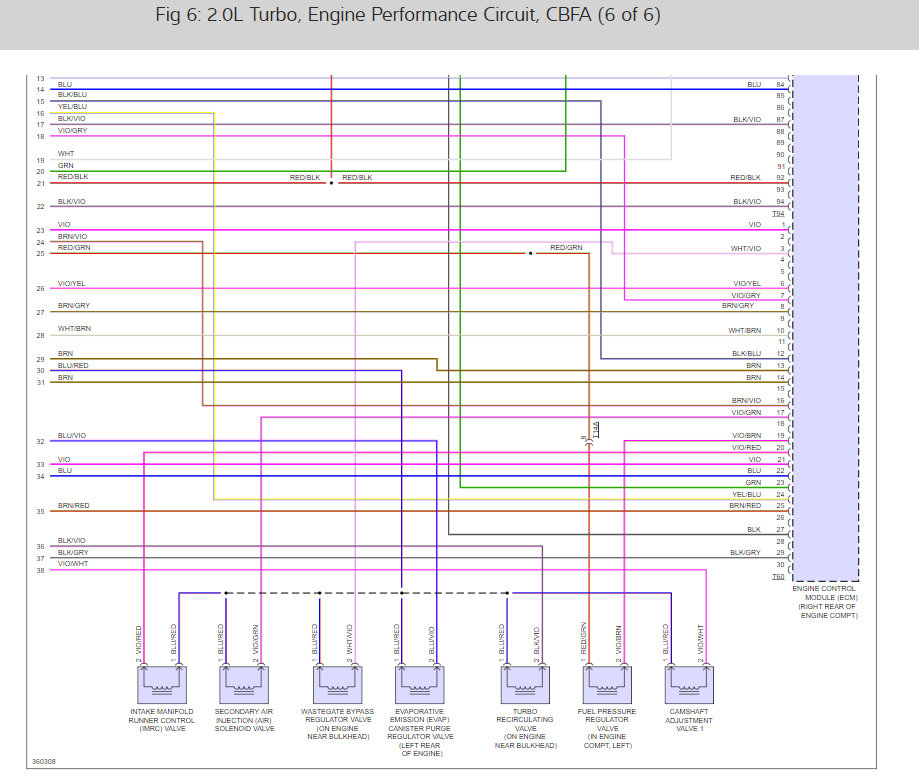

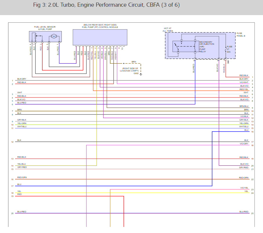

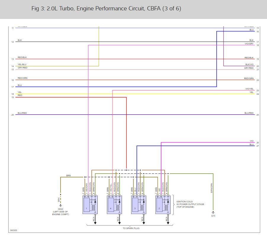

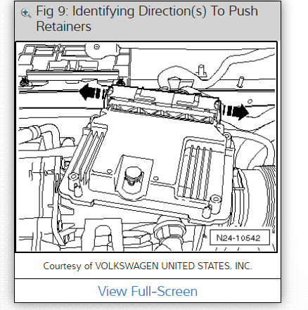

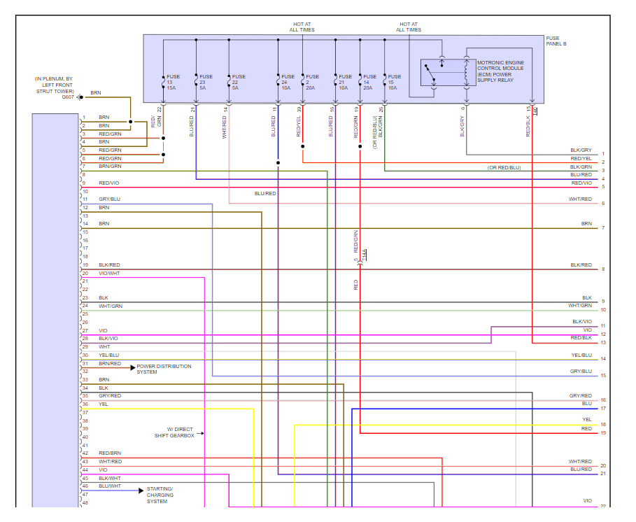

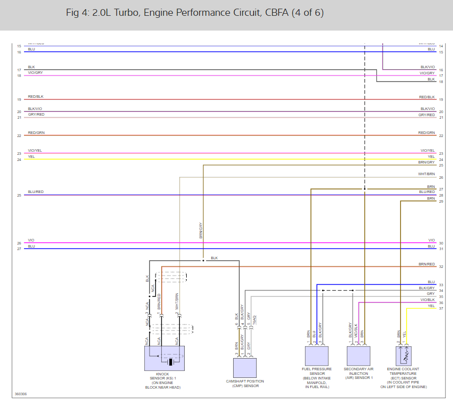

The first thing I would do it check the wiring between the sensor and the PCM. Here is a guide to helps with the wiring diagrams so you can see how the system works:

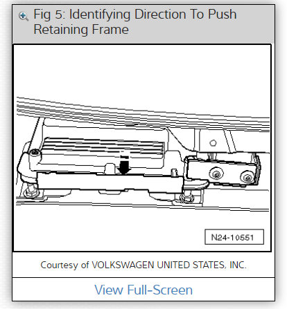

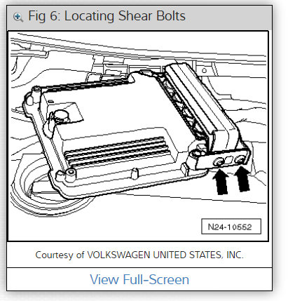

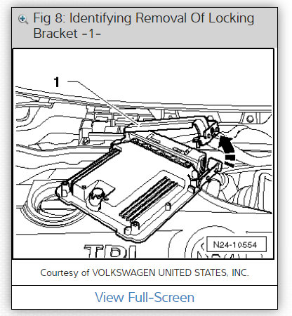

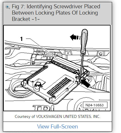

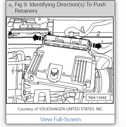

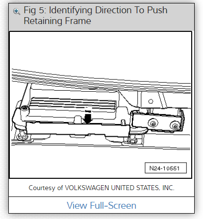

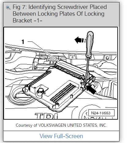

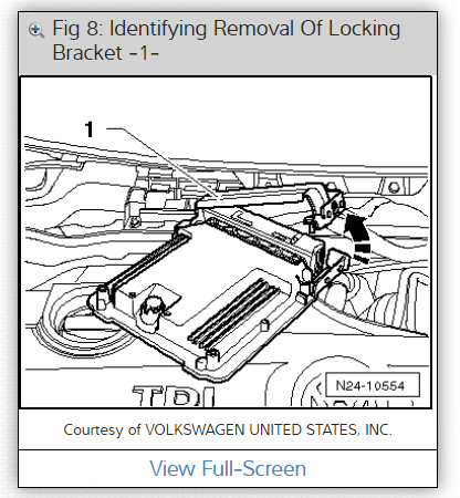

If everything checks out I would replace the PCM with a used/rebuilt unit here is the location of the PCM. The diagrams are for a 2.0 liter but are the same/similar.
This guide may help as well:
