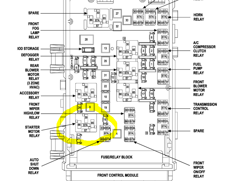

Van won't fire up the engine, all the electrical components are on. But engine intermittently refuses to turn over. I replaced the starter relay and it ran good for a week now it won't start
Apr 4, 2019 at 11:34 PM
Good morning,
Does the engine crank over? Trying to find out if the engine starter motor is working.
Apr 4, 2019 at 11:44 PM
LONGJ325
No, the engine is silent. Yet when it does fire up it is strong, as though nothing is wrong.
Apr 4, 2019 at 11:46 PM
Got it.

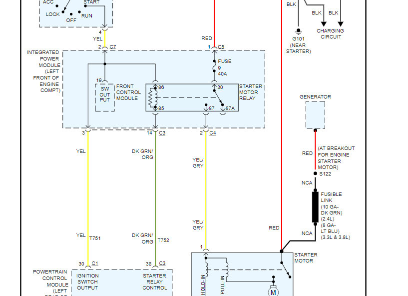

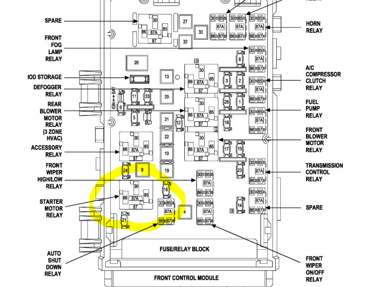

Do you have a voltmeter to do some checking? I attached wiring diagrams for you so we can do some checks.
Apr 4, 2019 at 11:51 PM
LONGJ325
No, but I will get one, that's the fuse I just replaced.
Apr 5, 2019 at 12:00 AM
We need to check the actual voltages at the relay.
Let me know when you get one.
