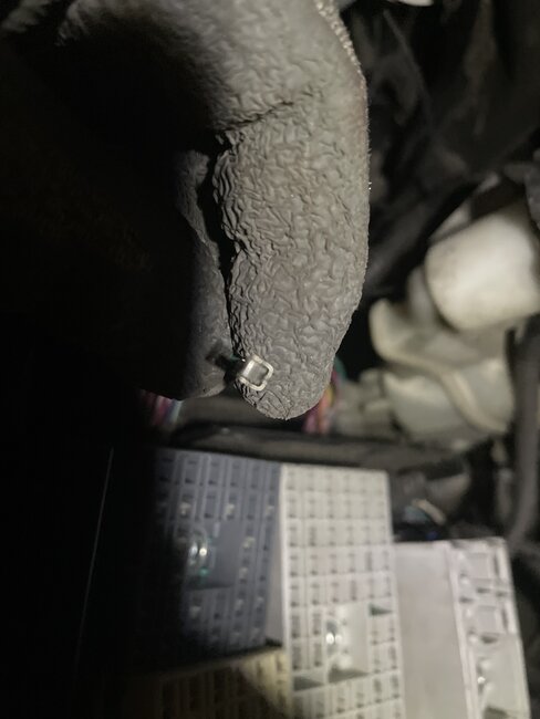

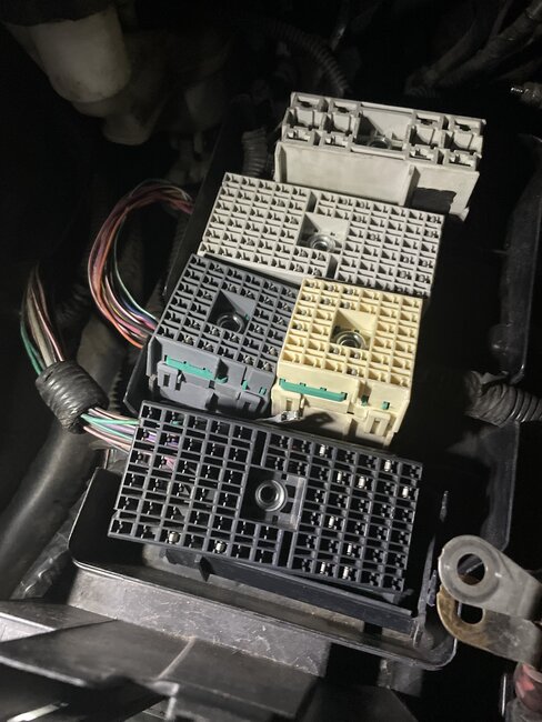

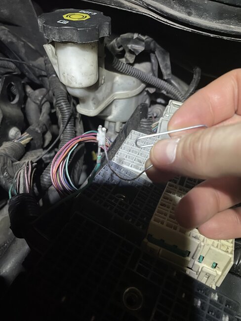

Checked fuses underneath hood and found two fuses not getting power both are 20amp fuses and labeled IP IGN & PCM/ECM. I loosened the five 7mm bolts that fastened the fuse box down to the bottom portion. Separated the top portion where fuses are and took apart the boxes to check the pins that the metal blades go through the top. Used a paper clip but found a flat head screw driver to use. Doing that helped get contact with the fuse IP IGN but didn’t work for the PCM/ECM fuse. Figured I have to trace that wire where its broken.

Since moving or working with the fuse block previously restored the IP IGN circuit and allowed the engine to crank, inspect the underside terminals, bus connections and connectors at the fuse block very carefully. Look for burned or discolored terminals, corrosion, terminals that have spread or lost tension, or a terminal that has pushed downward out of the connector.
I would stop using a screwdriver or paper clip to spread the fuse terminals. If a terminal has poor tension, spreading it may temporarily restore contact but can damage it further or create another intermittent connection.
