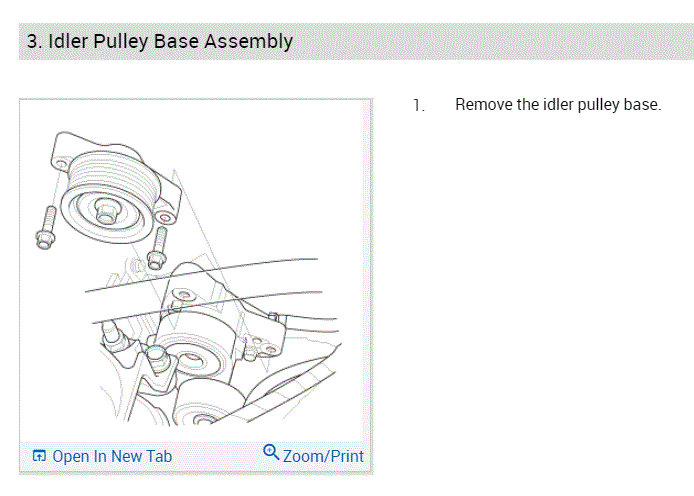

Battery drained last night. Jump started and was able to go to a local O’reily’s to diagnose. They reported my alternator working fine, battery was charging. My battery is 1 year old. They mentioned that the voltage regulator failed. I was able to start the car a few times last night without a problem. This morning I tried to start my car and the battery was drained again. Should I get a new battery or replace the alternator?

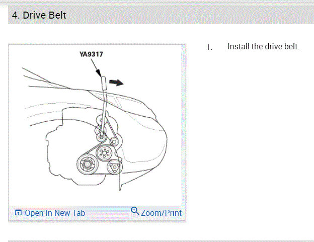

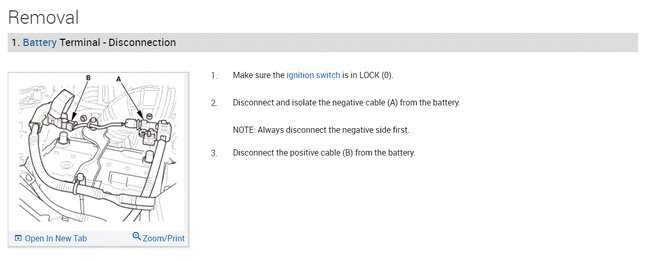

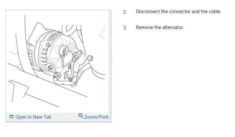

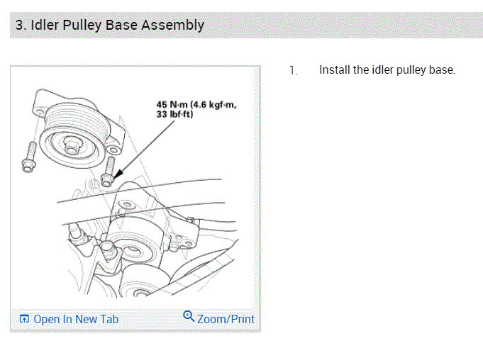

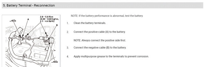

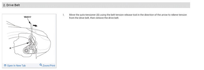

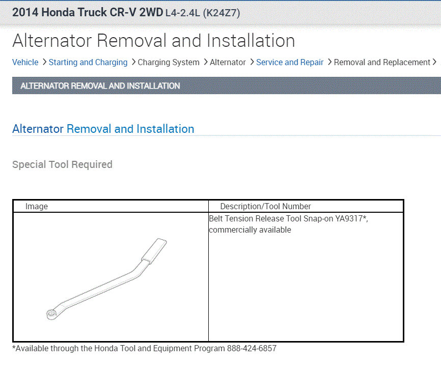

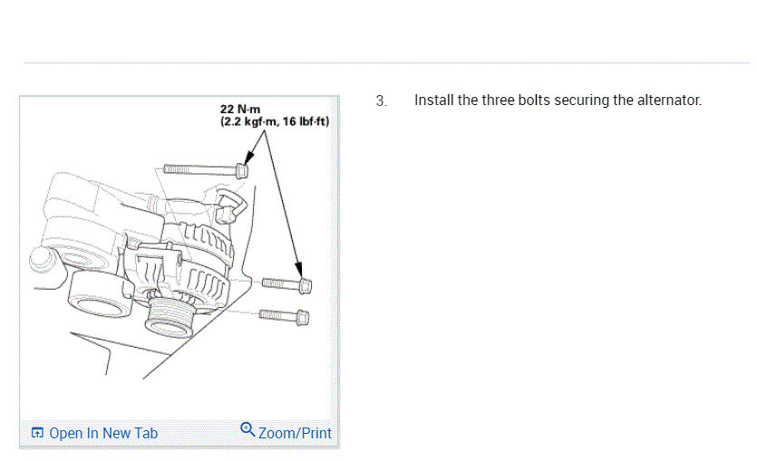

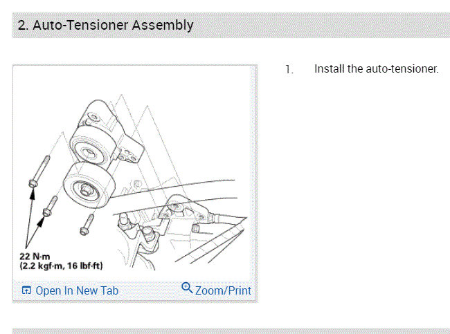

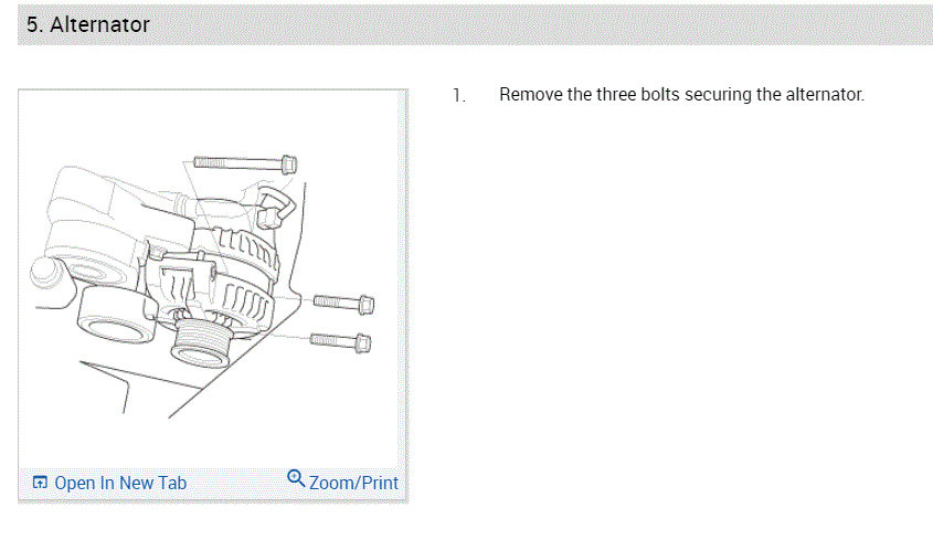

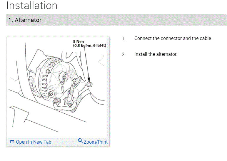

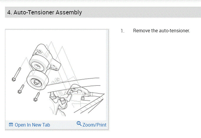

Also, I attached replacement directions specific to your vehicle below.
Let me know what you find or if you have questions.
