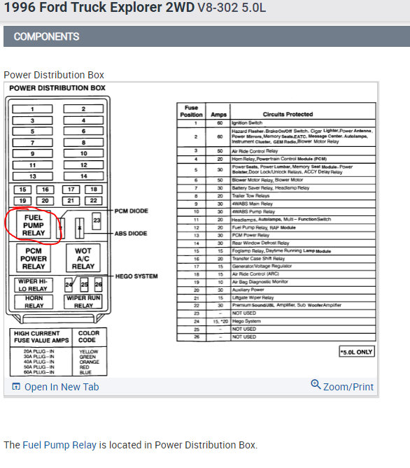

You can have an operative fuel pump due to a bad pump, faulty relay or wiring.
First you want to check the fuel pump relay.

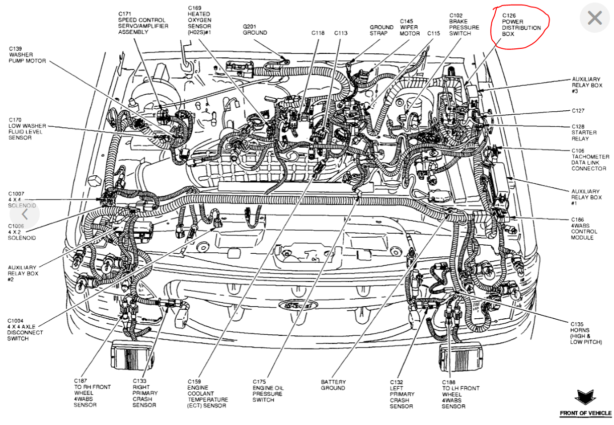

That relay is located under the hood in the power distribution fuse block (see diagrams below).
First look for obvious faults like bunt pin or burn connector.

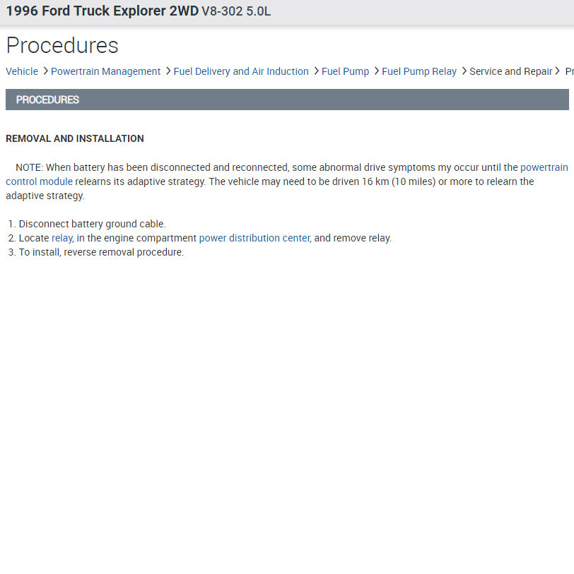

You can also test the relay, here is a guide on how to test relays:
You need to also check to see if you are getting power to the relay. In case there is a short in the wire to the fuse block.
Let me know what you find.
