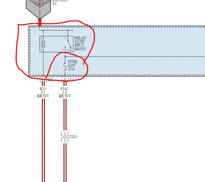

I've changed the battery, fuses, and the fuel pump. Had a mechanic look at it to verify that power is not going to the fuel pump. Where is the fuel relay?
Feb 21, 2020 at 3:25 PM
  • CAR REPAIR CONTRIBUTOR
  • 110,190 POSTS
The fuel pump relay is integral at the integrated power module, a part of the printed circuit board (PCB). It is not something that is serviceable.
The next thing I would suggest is to confirm the auto shut down (ASD) fuse is good. It is located in the power distribution box under the hood. See pic 1

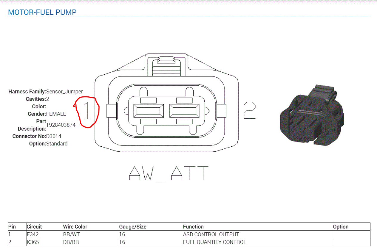

Also, if you look at pic 2, it shows you the pump connection for the ASD. If it fails, you lose the fuel pump.
Let me know what you find.
