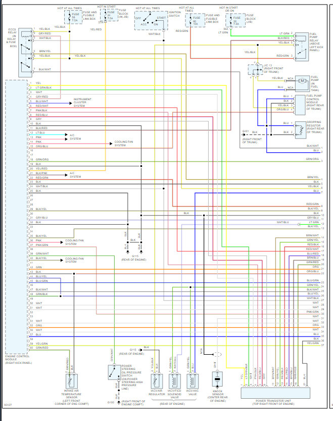

I replaced the stock stereo with an aftermarket one. afterwards I started the car and went to leave made it to the end of the driveway and it shut off and couldn't get it to start back. so I thought the fuel filter was clogged, so I replaced it nothing changed. then realized the fuel pump wasn't working, so I replaced that still no change. there is no power to my pump, so I changed the relay and still nothing. any ideas? There is power to the relay it is just not getting passed there. any clue? Thanks in advance!
Feb 12, 2019 at 10:43 AM
SCGRANTURISMO
  • 4,897 POSTS
When you say there is power to the relay do you mean both the control and power sides of the relay? It sounds to me like the relay is bad. I have included a link down below on how to test a relay.
Please run through this guide and let us know what you find out. I have also included a wiring diagram for the fuel pump circuit down below in the diagrams.

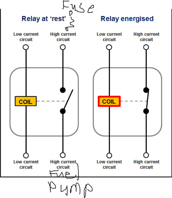

Hello again,
Have you checked the fuse supplying power back to the fuel pump? If you shorted out the power wire from the relay to the fuel pump then yes it would blow a fuse, that's what the system is designed to do. I have included two diagrams in the diagrams below. The first explains how a relay works. The other is the fuel pump relay circuit for your vehicle. See the light green wire that is going from fuse #30 to pin #2 on the relay. This wire has power only your vehicle is in run or start on the ignition switch.. The black/red wire coming from pin #1 of the relay is going to a ground. This is the control side of the relay. So when you power this side(run or start on ignition switch), it allows 7.5A of electrical current to energize the electro magnetic coil. When the coil is energized it pull the gate closed to make a circuit from pin #3 to pin #5. Pin #3 is fed from fuse #60, via the red/green wire, which is hot at all times. Pin #5 goes to the fuel pump(+) via the yellow/black wire. When the electro magnetic coil is not energized(ignition switch NOT in run or start) the gate will open, breaking the circuit to the fuel pump. Diagrams below.

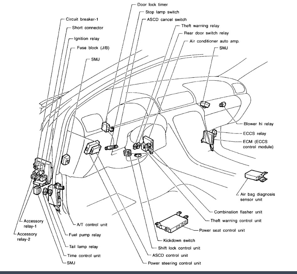

Where is that 7.5 fuse located at? I can't seem to find it.
Feb 14, 2019 at 8:11 AM
SCGRANTURISMO
  • 4,897 POSTS
Hello again,
I have included a blown up diagram of the Under Dash Fuse Panel. This is where the fuel pump relay is located. You can find all the wires we discussed earlier there. It is called fuse block J/B.

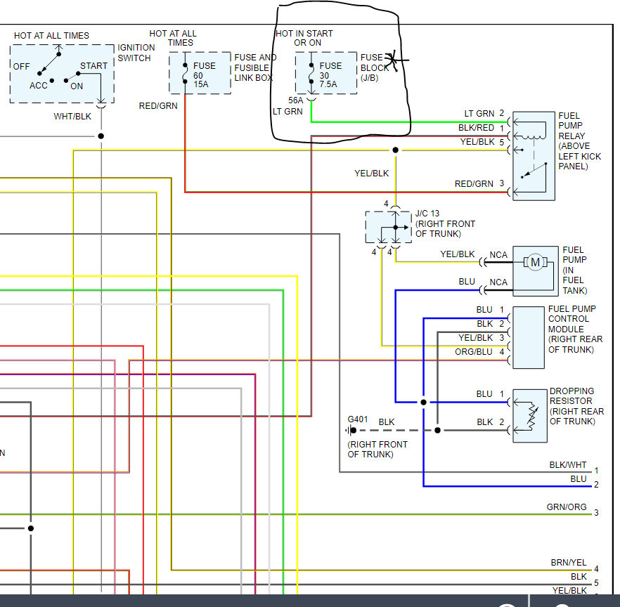

The light green wire has no power to it with key on.
Feb 16, 2019 at 8:43 AM
SCGRANTURISMO
  • 4,897 POSTS
Hello again,
Okay, the relay is not getting power to the electromagnet. Double check fuse #30 (7.5A) in fuse box J/B from the previous diagram. It is on the left side of the dashboard. Let me know what you find out please.

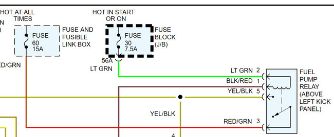

CEPPERSON1998
  • 8 POSTS
There is no fuse in the j/b fuse box marked for that. do you know what it would be called?
Feb 16, 2019 at 8:53 AM
SCGRANTURISMO
  • 4,897 POSTS
Hello again,
There is no 7.5A fuse in fuse box J/B in the left hand side of the instrument panel. Is there an empty slot for a fuse to go into?
Thanks,
Alex
2CarPros
Feb 16, 2019 at 9:40 AM
CEPPERSON1998
  • 8 POSTS
No, I don't see any empty slots and I didn't see one. I checked all the 7.5 fuses and they all were good.
Feb 16, 2019 at 9:45 AM

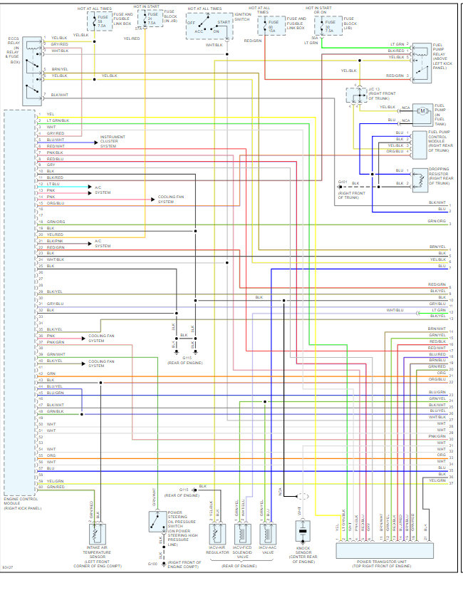

SCGRANTURISMO
  • 4,897 POSTS
Hello again,
If there is no fuse in fuse box J/B then that is the problem. I am including two more diagrams for you in the diagrams below. Look them over. If you are still having difficulty follow the light green wire from the fuel pump relay back. It should lead to the fuse that more than likely is our culprit..
