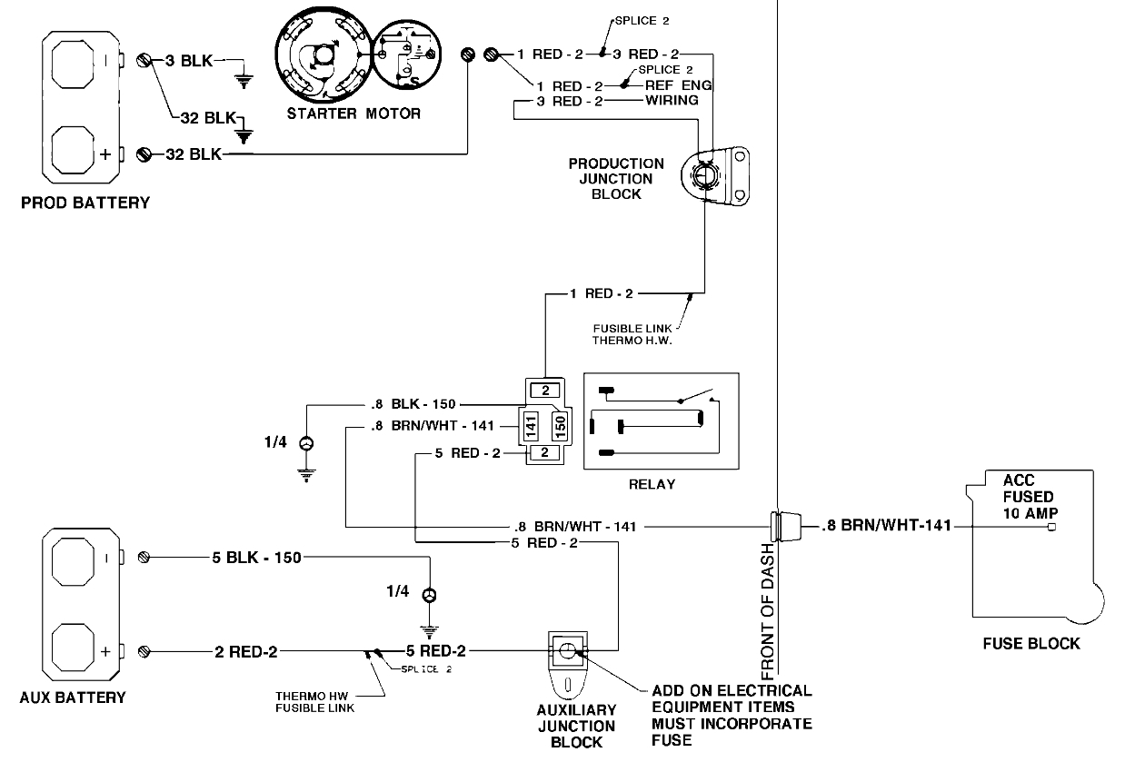

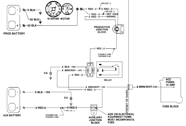

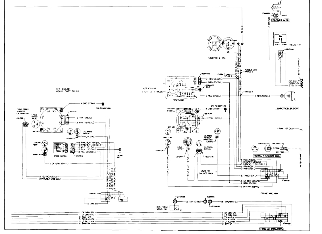

I bought a new Alternator because my battery wouldn't charge, so I bought a new isolator because it wouldn't charge the battery. it started just fine until I changed isolator now it will only start if I Jump large post of isolator to ground on Alternator bracket where I have isolator bolted to.
Feb 11, 2024 at 8:31 PM
  • 55,447 POSTS
I don't know how the isolator is wired but here are the wiring diagrams for the alternator and starter, I would go back to basics and make sure the connections are correct. Here is a guide that may help as well, and I have included the wiring diagrams for the starter and alternator systems, one of them is a little hard to read but it is all they are giving us.
Check out the images (below). Please upload pictures or videos in your response to the problem so we can see what's going on.
