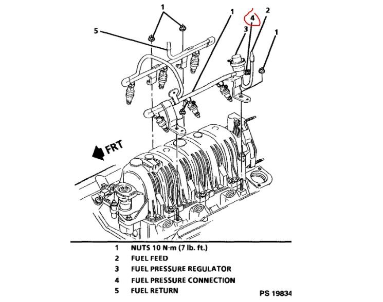

Not starting
100,000 MILES • 6 CYL • 2WD
JOHN LADUE
It seems like there's no spark.
Mar 6, 2021 at 2:26 AM
Good afternoon,
I attached some guides on how to check for fuel pressure, spark and compression.
Can you hear the fuel pump run when you first turn the key?
https://www.2carpros.com/articles/how-to-replace-an-electric-fuel-pump
Mar 6, 2021 at 5:37 AM
JOHN LADUE
Yes.
Mar 6, 2021 at 5:41 AM
Okay, I would test the actual pressure.
FUEL PRESSURE
1. Ignition "OFF" for 10 Seconds.
2. With ignition "ON," engine "OFF" and fuel pump running, pressure should be 333-376 kPa (48-55 psi).
For additional fuel pressure testing, See: A L L Diagnostic Trouble Codes ( DTC ) > Related Tests, Information and Procedures > Diagnostic Chart
I attached the location of the test port for you to test.
