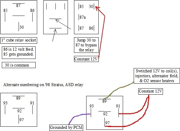

Are you on the dark green / orange wire at the ignition coil? Most importantly, are you cranking the engine when checking for voltage there? If not, you'll only see 12 volts for the first one second when the ignition switch is turned on to "run".

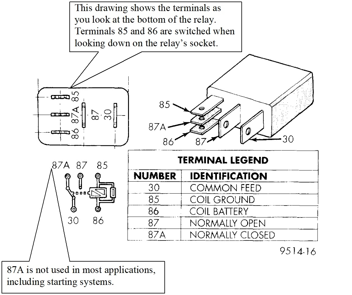

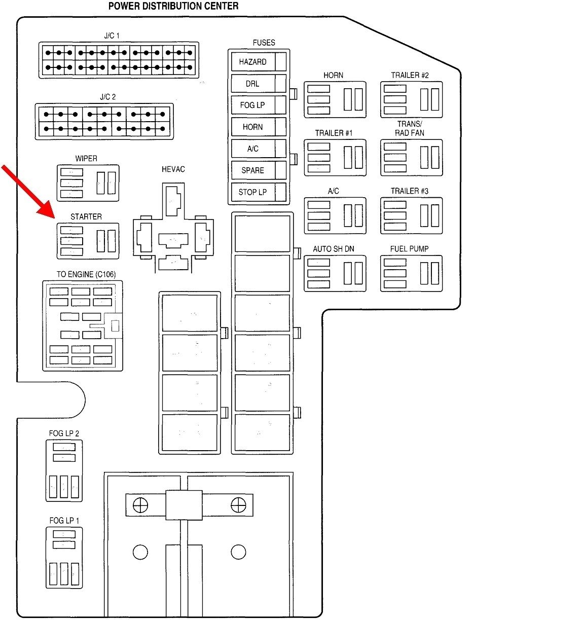

If you really are missing the 12 volts, remove the ASD relay in the under-hood fuse box, then check for constant 12 volts on terminal # 30 in the socket. In the first drawing, the ASD relay is shown in the middle of the right side. In this sad second drawing I put together, use the middle relay in the top row. As I recall, terminal # 30 is the one the lower arrow is pointing to. If I'm wrong and you don't have 12 volts there, check on the other terminals with the ignition switch off. If it's missing, check fuse # 3, a 30-amp. Sorry to say, I've looked before, but they just couldn't be bothered to label the smaller fuses. You'll have to look for any 30-amp fuses. # 3 will usually be pretty close to the ASD relay.
