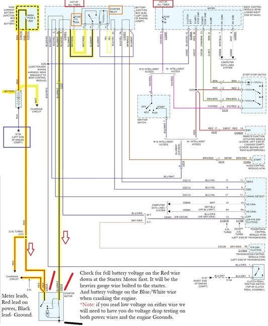

Car tries turning over but doesn't start. I have changed the starter and battery. It makes a clicking sound the lights work

Hello, so the engine tries to crank over but only clicks sometimes? Is that a correct description of the issue?

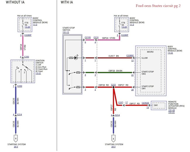

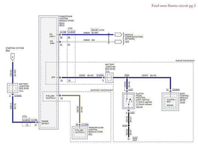

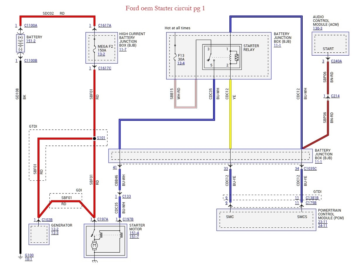

Ill post the wiring diagrams for the Starter motor circuit, but it sounds like either there isnt full battery voltage reaching the starter, or you have a bad ground. The starter motor pulls hundreds of amps when cranking, if the ground path of the vehicle has an issue, there is no return path for all that current. Or you got a new bad starter. That happens all the time now.

The first diagram is the Starter wiring diagram, it looks complicated being so compact. But really you need to check for full battery voltage on both wires at the starter. You'll need someone to crank the vehicle while you are checking voltage on the Blue/White wire since its the control wire that energizes the starter solenoid. Here are some guides to help. Let us know what you find.
