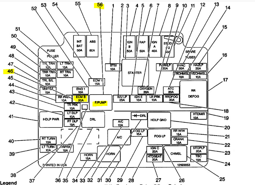

Not starting, no power to the fuel pump?
1999 CHEVROLET S-10
260,000 MILES • 2.2L • 4 CYL • 2WD • MANUAL
RONNY BONES

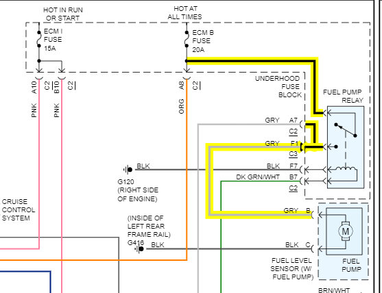

I'm not getting any power to my fuel pump from the key turning to the start position.
May 21, 2023 at 4:06 PM
  • 110,194 POSTS
First, check to make sure the ECM B fuse is good in the under-hood fuse box. In addition to checking the fuse, confirm there is power to and from it.
If that is good, remove the fuel pump relay and switch it with a different one having the same part number to see if that helps.
If there isn't a different relay with the same part number, here is a link that explains how to test a relay and circuit:
Start with this and let me know the results.
