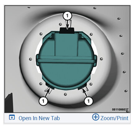

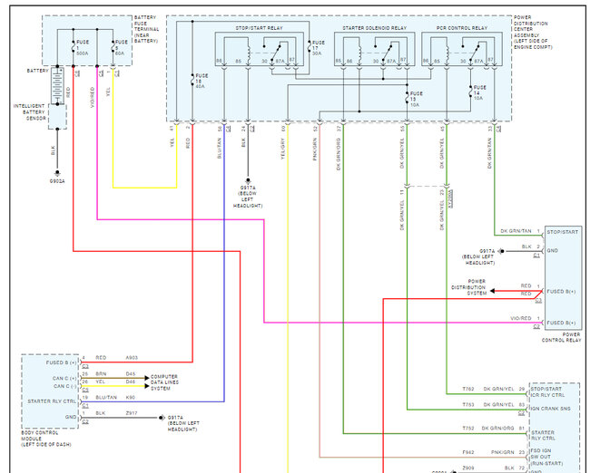

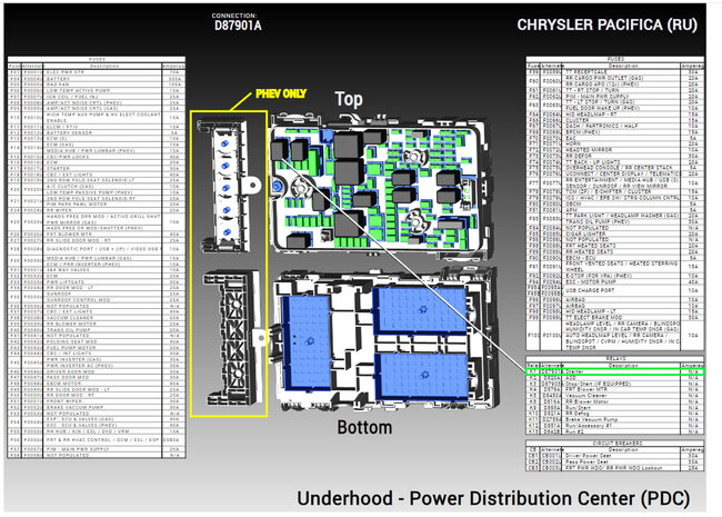

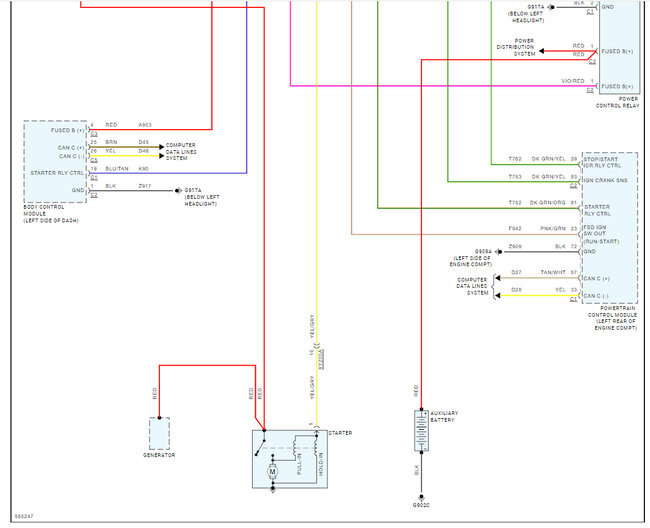

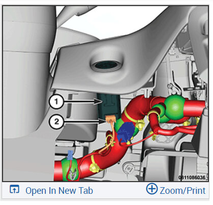

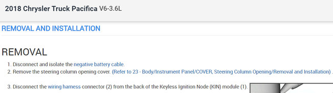

These cars have had problem with the push button switch itself or the starter relay, but to be sure there is a guide to help, and I have included the wiring diagrams so you can see how the system works and how to change out the switch and relay location as well.
