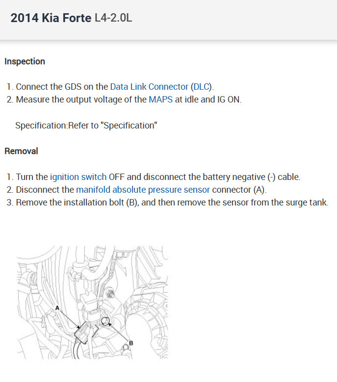

Okay, you must have the vacuum line or the electrical connector to the MAP sensor off or it is not sealed well. Please recheck your work and let's run the codes to see if any are stored.
Here is the location of the sensor so you can check it out. Check out the images (below). Please let us know what happens.
