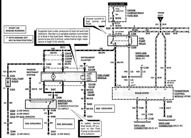

the engine turns, it does not start.
May 29, 2017 at 4:47 AM
STEVE W.
  • 15,401 POSTS
OK you need to determine if you have spark and fuel. For that you need a spark tester and a fuel pressure test gauge. Do you hear the fuel pump turn on? What occurred prior to this problem? Any warning lights on the dash?
May 29, 2017 at 11:58 AM
JUVENCIO
there is not fuel pressure,spark yes, there is no power to the shut-off switch,new fuel relay
May 31, 2017 at 7:46 AM
STEVE W.
  • 15,401 POSTS
Start at the pump fuse and trace the power to the pump. Only takes one bad/broken connection to kill the power.
