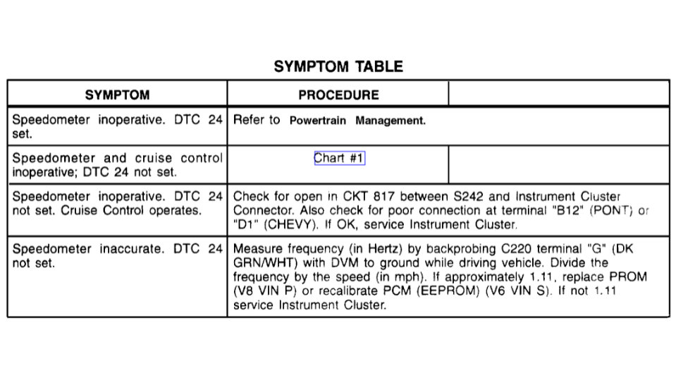

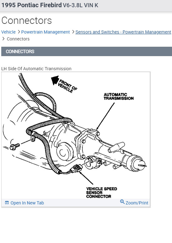

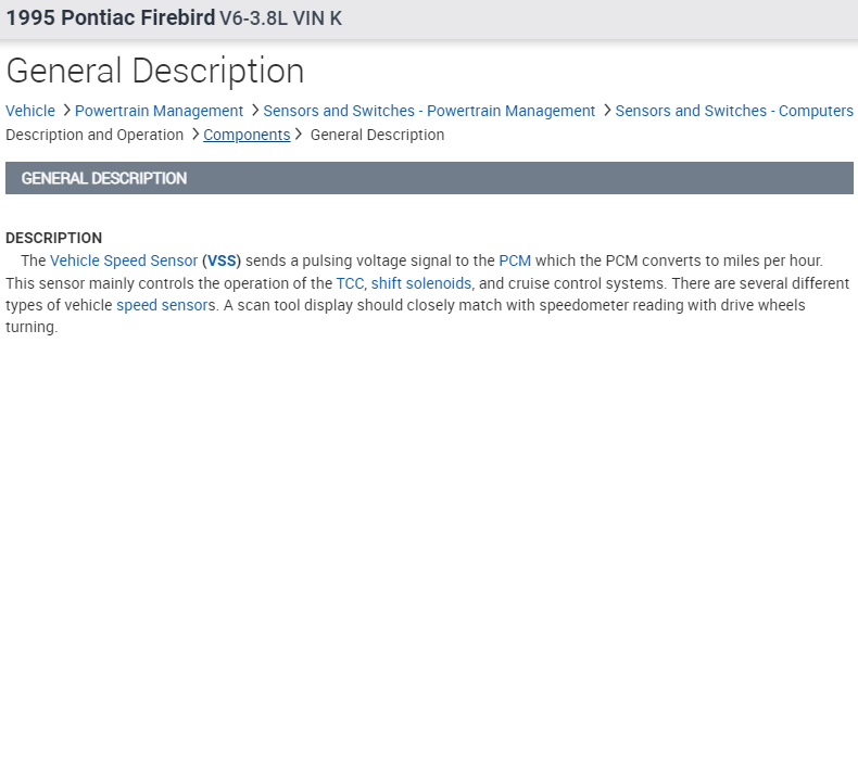

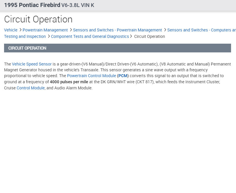

Since the speedometer stopped working, the issue is likely the vehicle speed sensor (VSS).
The VSS is located on rear of the transmission on the driver side (see diagram below).
Make sure that the connector is secured and does not have any corrosion.
If everything is secured and clean but you still have the issue, then it is probably a bad sensor.
