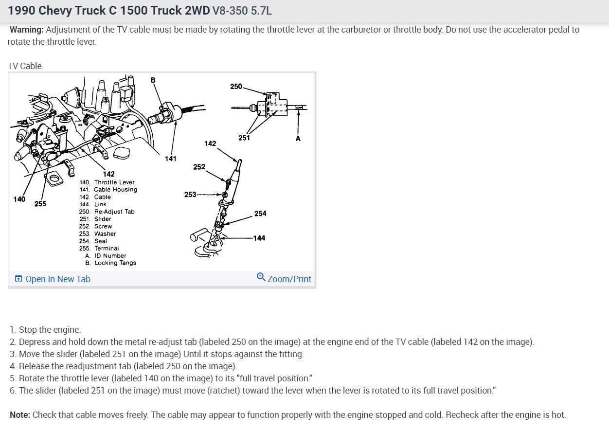

It goes in reverse and drive just fine but won't shift out of first gear. Not even manually
Mar 29, 2023 at 10:10 PM
  • 55,758 POSTS
The first thing to do is check the transmission fluid level, if you have not already. If the level is okay check the TV cable at the throttle body. Here is a guide that can help and please check out the image below:
Check out the images (below). Please let us know what you find.
