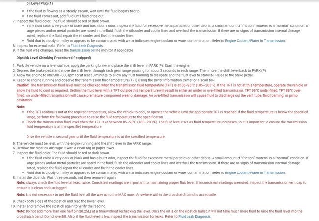

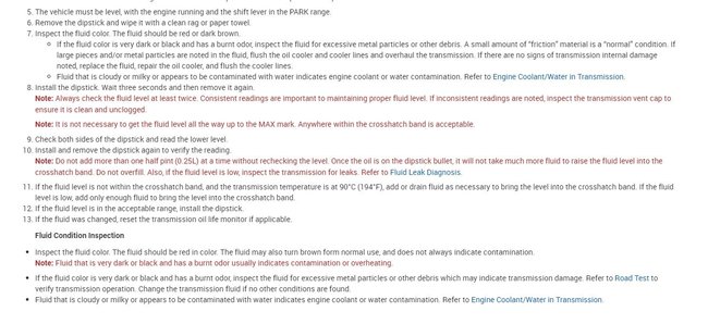

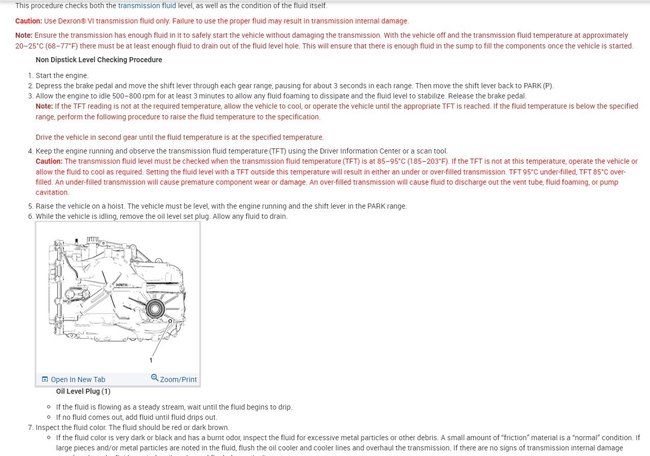

Okay, the first thing I would check is the fluid level. I attached the procedure below for checking the fluid level and condition.
https://www.2carpros.com/articles/how-to-check-and-add-transmission-fluid
