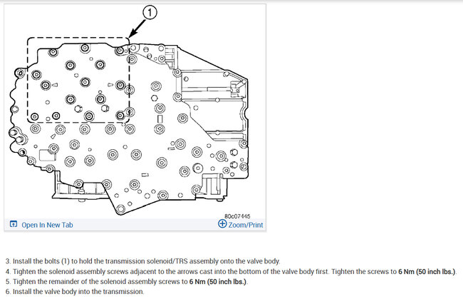

As you know these codes have to do with the line pressure, when you checked it what was the pressure? If you have a mechanical internal problem inside the transmission for the 3rd gear it will dump pressure giving you the code, the only thing I would try is replacing the Control Solenoid Valve "B".

If that does not work, I believe something inside the transmission has failed. Check out the images (below). Please let us know what happens. Thanks for the detailed question.

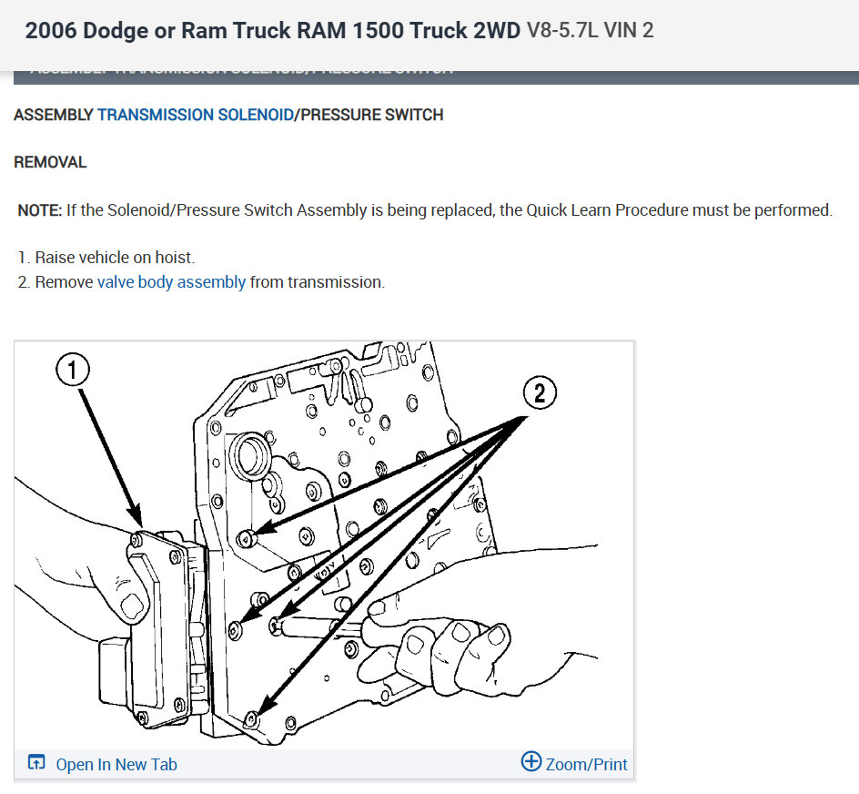

Is control solenoid valve B its own separate part, or is it a part of the main solenoid pack? I replaced the main solenoid pack about 3 years ago, so I’m familiar with that, but when I searched for “solenoid valve B” I did not find that part online for my truck.

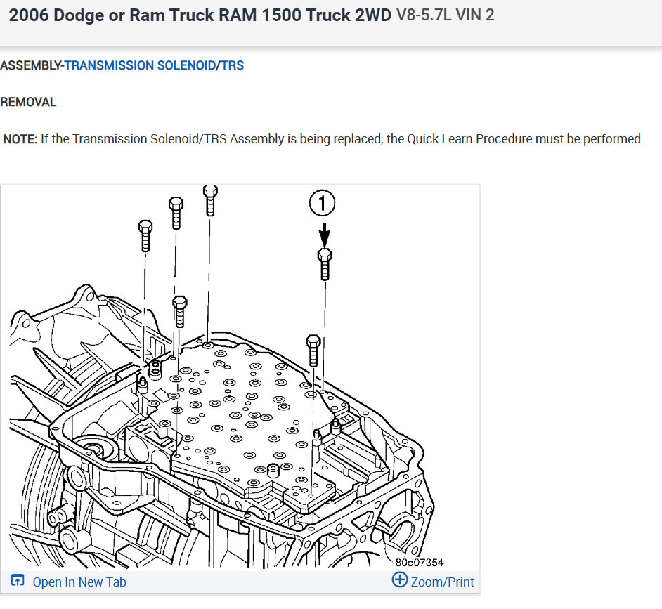

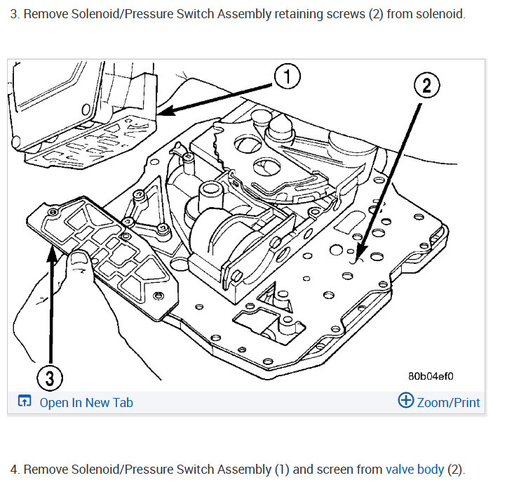

Yep, it looks like the pressure control solenoid is its own separate part. But I can tell you that if there is a problem with the transmission internally it can give these codes as well. Here is how to change the pressure control solenoid out, it is worth a shot. Check out the images (below). Please let us know what happens.
