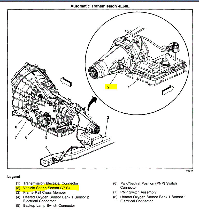

If the speedometer isn't working, I suspect it has to do with the vehicle speed sensor. If you have a live data scanner, plug it in and drive the vehicle to see if the scan tool indicates a speed. If it doesn't, replace the speed sensor. I attached a pic below of location on this transmission.
Let me know what you find.

The transmission in truck or the old one in the bed don't have speed sensor as the image you sent me. My are on the transfer case. Have 3 with same number 2 or on tail of it was told the one on right side goes to the dash the other one is to read the mph I am guessing input, output have one on to I am thinking for 4wd speed. I checked all plug connections that I found going back to them I put new ones in. If I can figure out how to send you a pic will send you one of old ones. Don't know where to look at next.

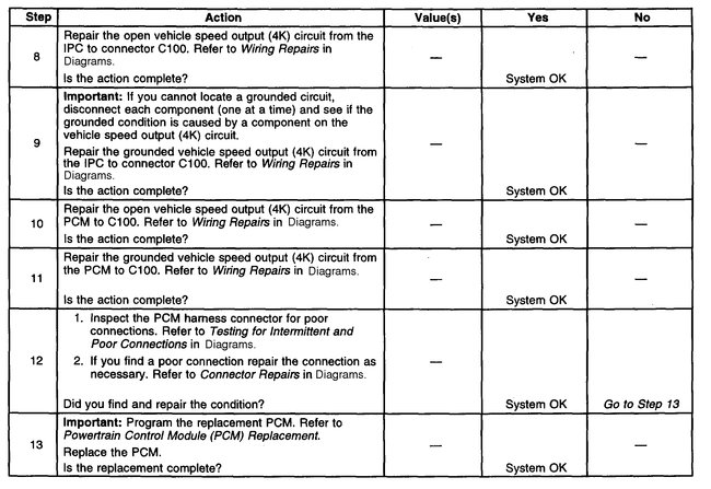

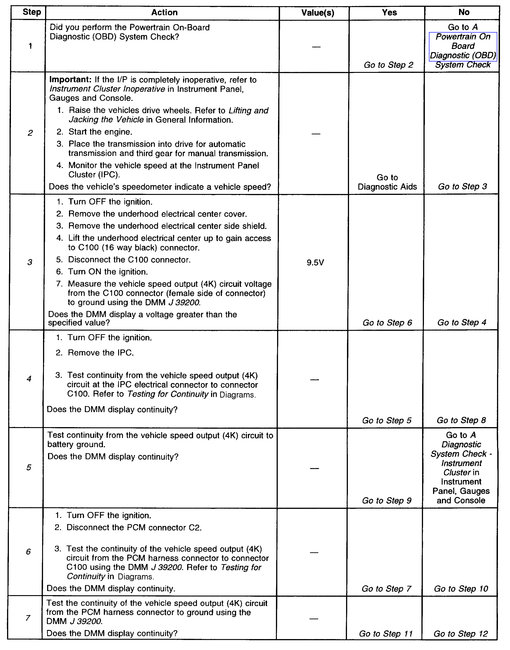

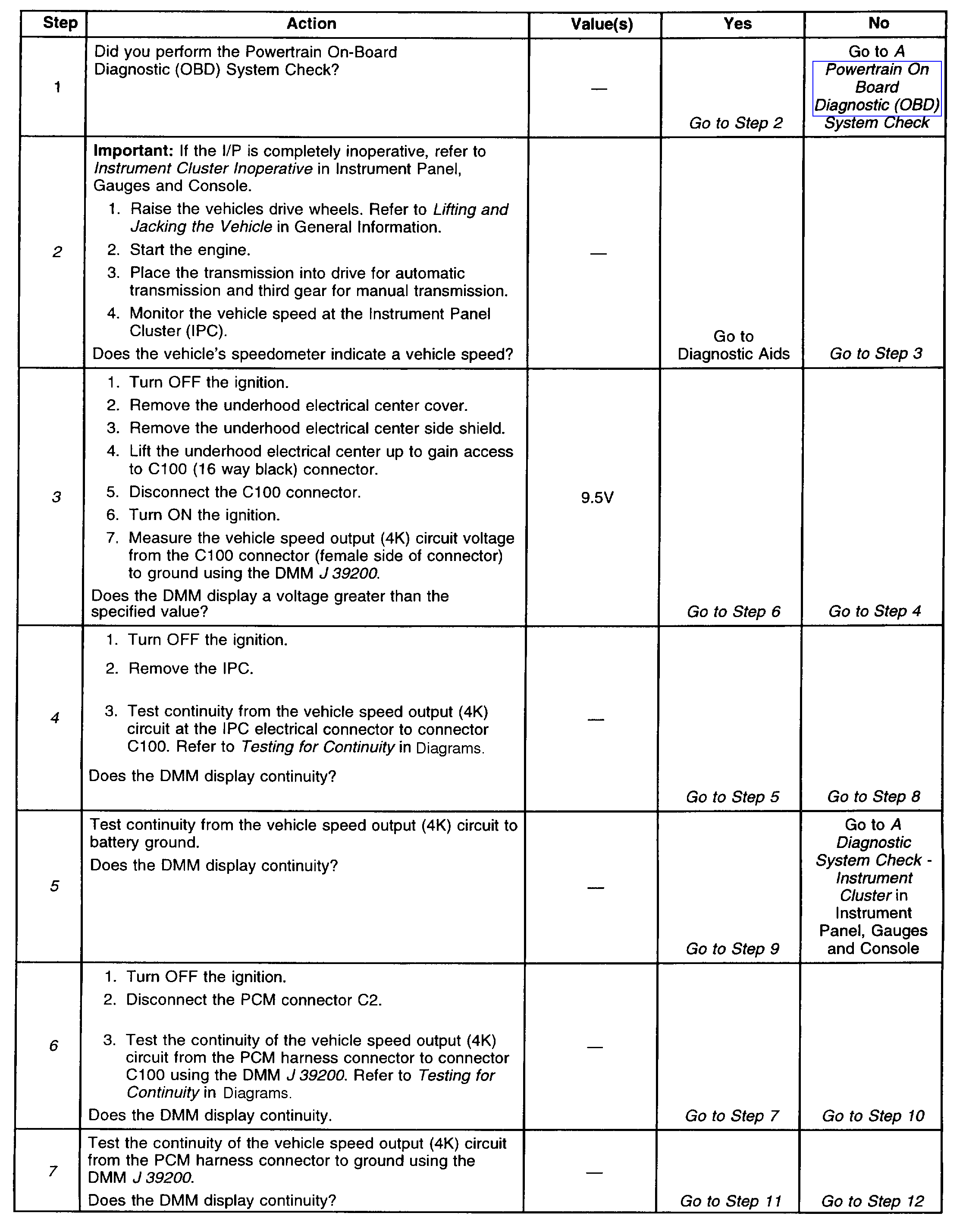

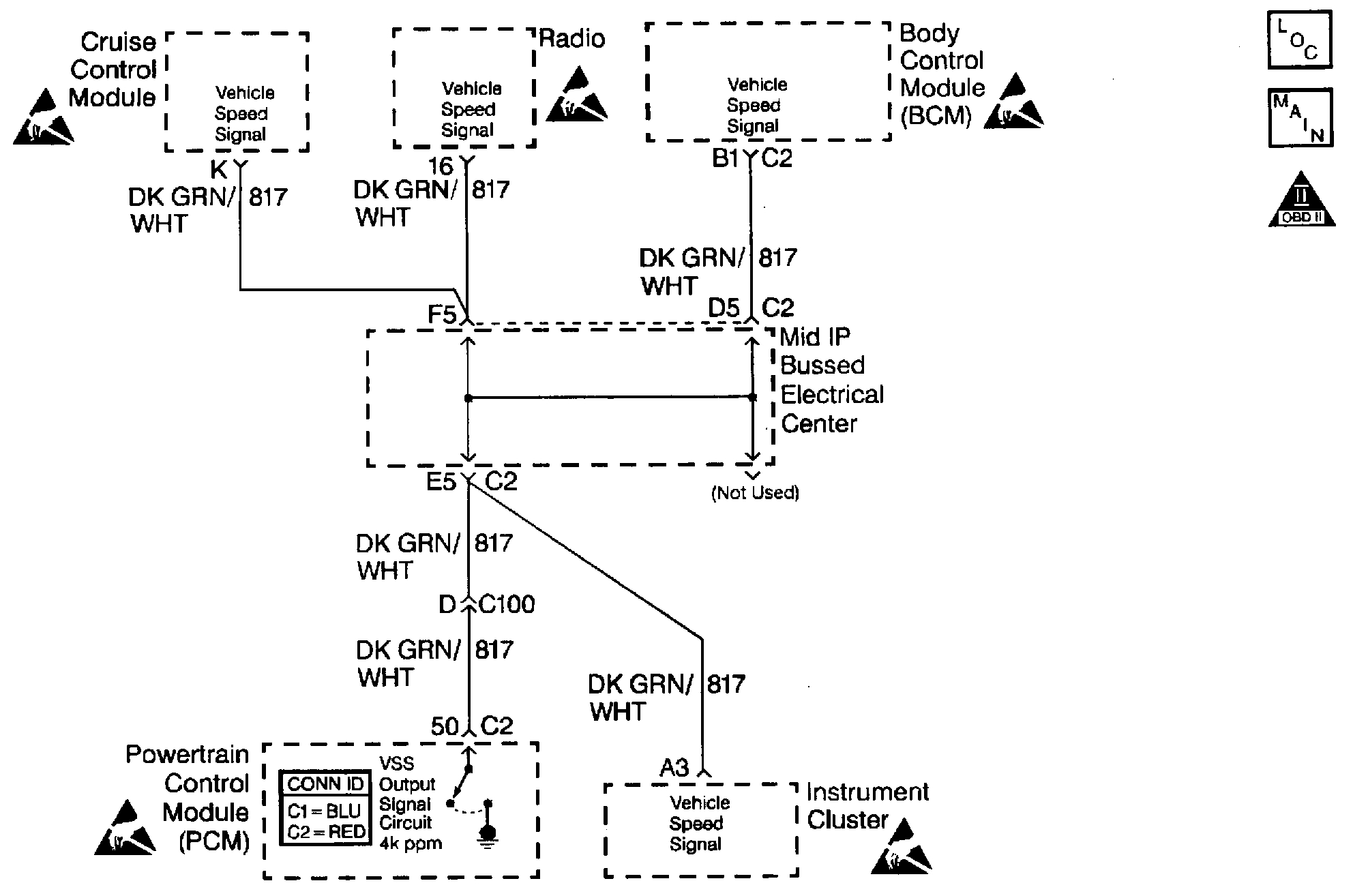

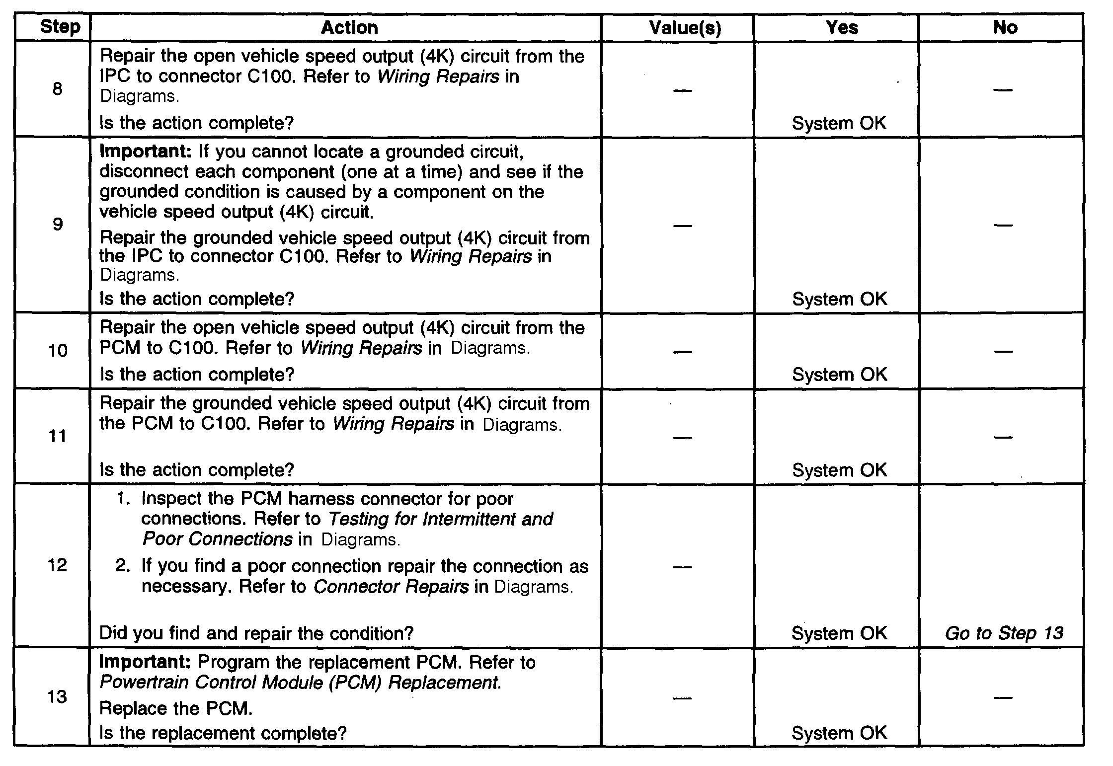

  • 109,885 POSTS
This is going to be a tricky one to diagnose. The idea that it is showing a 3 mph signal when the vehicle is stopped indicates there is either a short to power or excessive resistance in one of the wires between the VSS and PCM.
Here are the diagnostics that explain how to trouble shoot this type of issue. They are somewhat extensive and require general knowledge of how the electrical system works.
The attached pics are the actual flow chart. Take a look through them and let me know if you are comfortable doing it Also, if you have retrieved a specific code, let me know that as well. It may help narrow things down.
__________________________________________________
2000 Chevy Truck K 1500 Truck 4WD V8-4.8L VIN V
Vehicle Speed Output Circuit Diagnosis
Vehicle Powertrain Management Sensors and Switches - Powertrain Management Sensors and Switches - Computers and Control Systems Vehicle Speed Sensor Testing and Inspection Component Tests and General Diagnostics Vehicle Speed Output Circuit Diagnosis
VEHICLE SPEED OUTPUT CIRCUIT DIAGNOSIS
Diagnostic Chart (Part 1 Of 2)
see pic 1
Diagnostic Chart (Part 2 Of 2)
see pic 2
Schematic
see pic 3
CIRCUIT DESCRIPTION
Various components apply a voltage to the vehicle speed output circuit. The Powertrain Control Module (PCM) creates the vehicle speed output signal by rapidly grounding this circuit via an internal switch called a driver. The driver operates at the same rate as the Vehicle Speed Sensor (VSS) signal input. The various components recognize the voltage being pulled to ground as an indication of vehicle speed.
