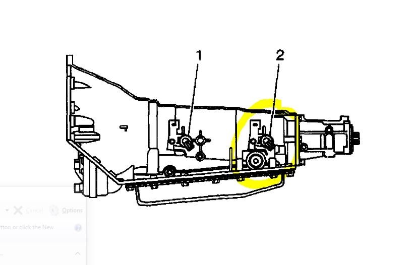

Not shifting
2002 CHEVROLET TAHOE
250,000 MILES • 5.4L • V8 • 4WD • AUTOMATIC
PAT MOYNIHAN
Performed transfer case pump repair.
New pump housing.
New case cover.
Now wont shift passed second gear.
And that must be done manually.

PAT MOYNIHAN
PS:
Sorry I forgot to mention the ABS light is on.
Sep 18, 2019 at 4:22 AM
Good afternoon,
Does the speedometer work?
Are there any codes stored?
I need the ABS code as well.
https://www.2carpros.com/articles/abs-warning-light-on-easy-repair-guide
The speed sensor and the TPS are responsible for the shifting times.
