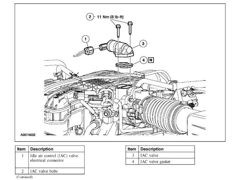

It will not go in reverse or drive trying to cut off and after it sets for a while it straightens out for about a month and goes right back to not working again. Code is po171 174 sometimes.
Nov 17, 2018 at 4:13 PM
Good evening.
There is an idle control motor on top of the intake that keeps the idle steady. It sounds like that is not working all the time.
The 171,174 is for a lean condition. I will post possible causes.
