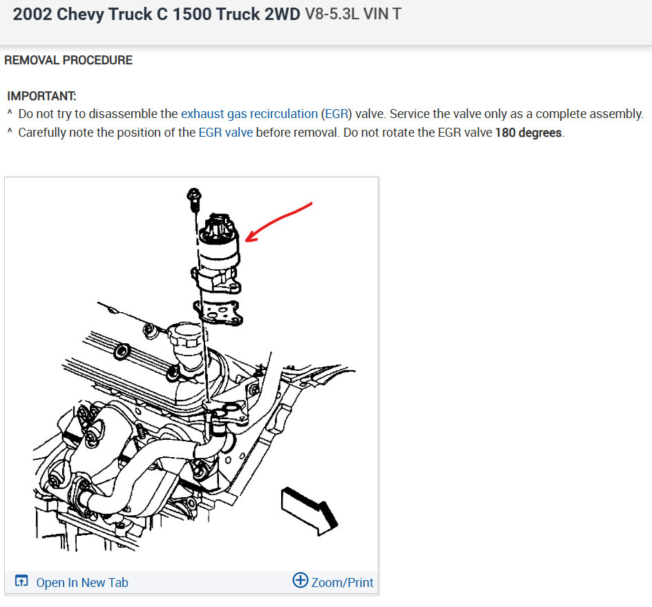

So the EGR valve can leak slightly and cause the same effect as a vacuum leak. Also, here is a video we just did which is a better way to find vacuum leaks:
https://www.youtube.com/watch?v=LRKWV4Are5c&t
I would try swapping out the EGR to see what happens or you can try testing it using this video:
https://www.youtube.com/watch?v=DqUCbbKdWf4
Check out the images (below). Let us know what you find.
May 20, 2025 at 8:56 AM

I did the vacuum leak test already with some starting fluid couldn't find a change in rpms anywhere, going to test the EGR now and I'll get back to you, maybe with a video of truck idling and foot on pedal.

Still having problems with it sounds way better than it did, may just be the engine is worn out it's got 3 or 400,000 miles on it ol farm truck.
