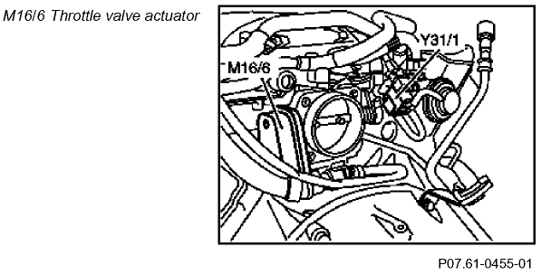

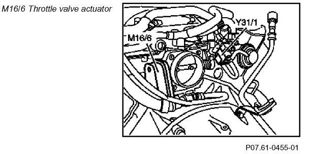

Then you have a throttle body and injectors. The one in the video was not your make/model, it was just to show how the throttle body can be gunked up and cleaned. Sorry if it was confusing.
Yours is M16/6 in these pictures. There isn't a video guide for that exact vehicle which is another reason I suggested taking it to a shop.

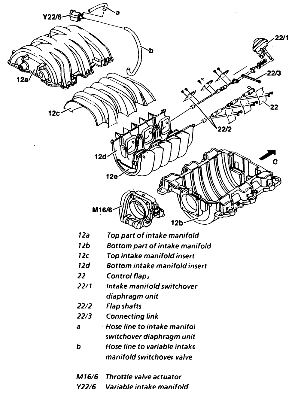

This car will go into limp mode if you have a vacuum leak somewhere in the intake system or intake tube. Here is a guide to help you confirm the issue.
