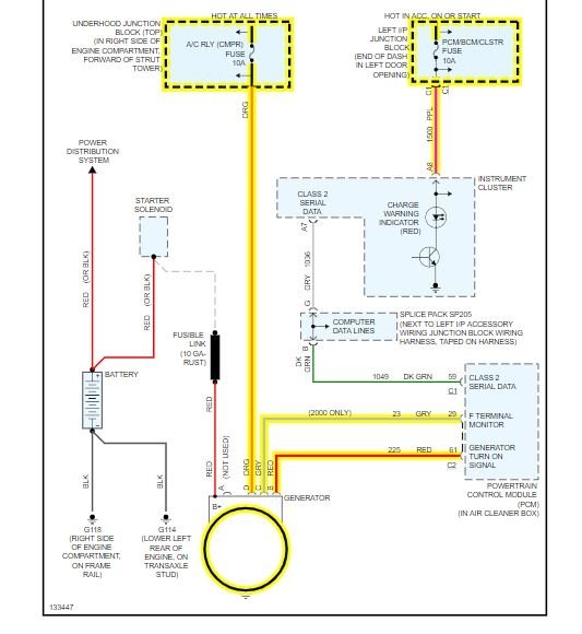

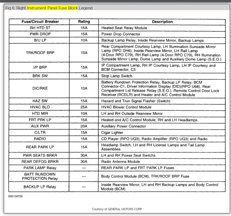

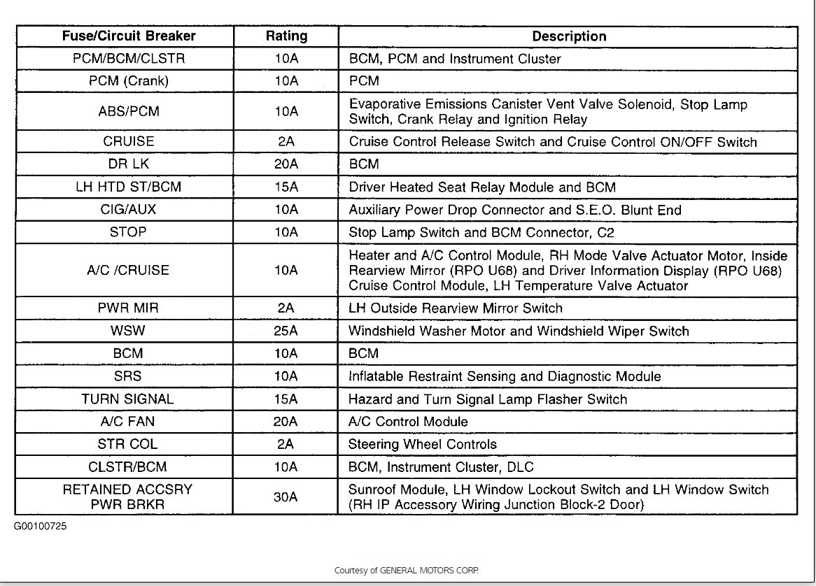

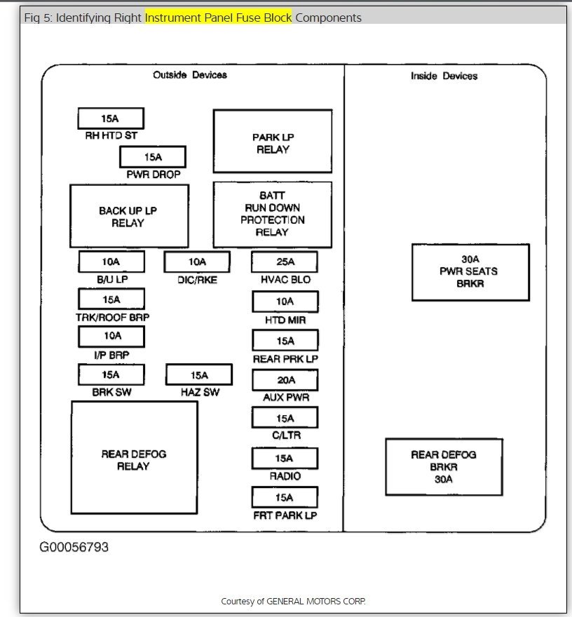

It seems the alternator is not working. I'm about to check connections, and was looking for a fuse to make sure no issue there.

Good morning, I attached a wiring diagram for you to view.
Check the fuses listed for power on both sides.
Check out the images (Below). Please let us know how it goes

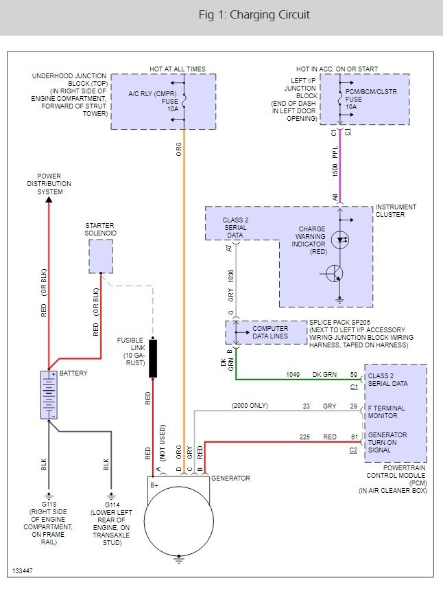

where is alternator fuse for 2000 chevy impala

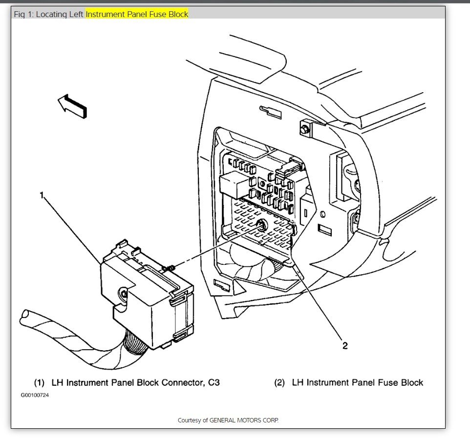

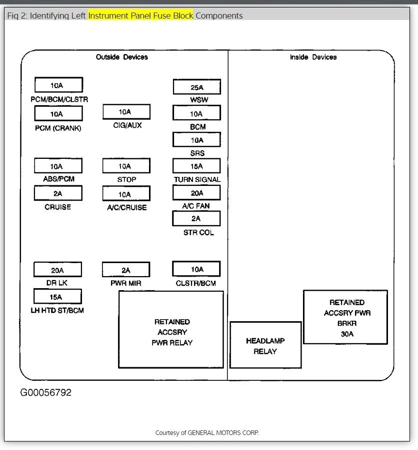

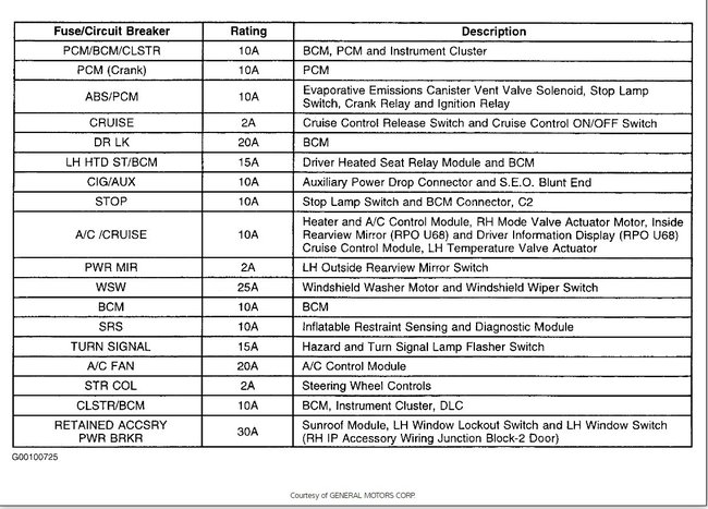

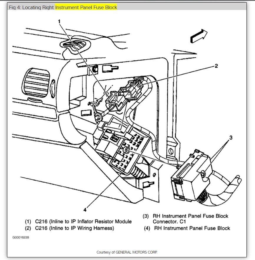

The alternator fuse is the AC compressor clutch fuse they share the circuit. I have found the wiring diagram for the alternator and the fuse locations, (below) Here are some guide that will help you do some testing.
Check out the diagrams (Below). Let us know what happens and please upload pictures or videos of the problem.
