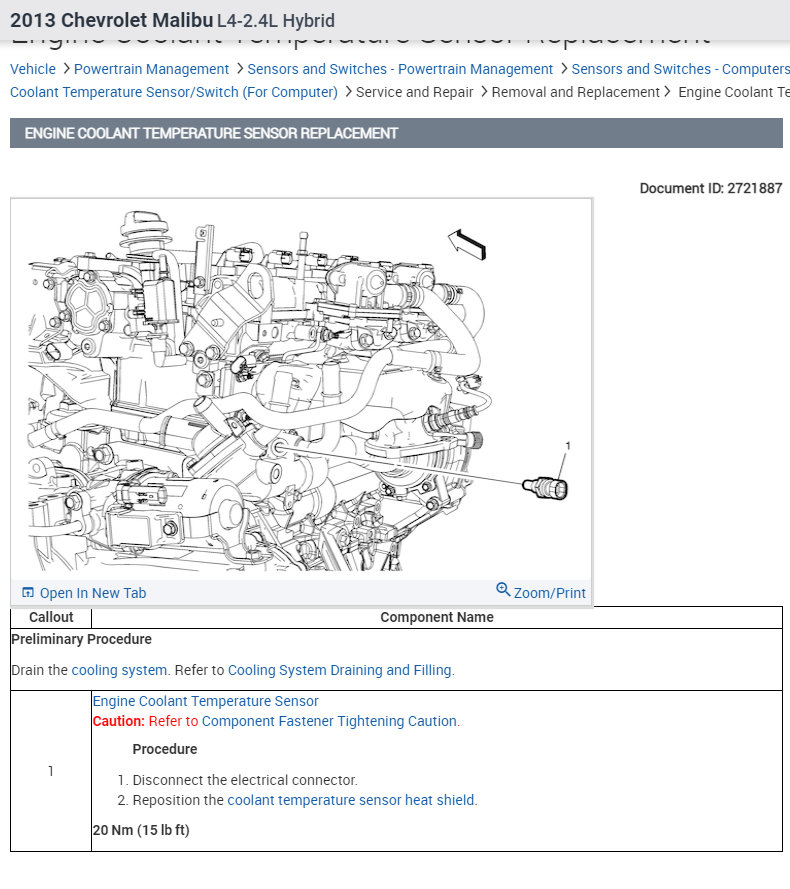

Overheat alerts on dash display with temperature pinned to the hot side of the gauge. i had just started the car. not even warm yet. The fan is in full blast mode coolant in the tank and circulating, no leaks, the belt is fair and no noise from the water pump. After shutting off and cooling down for 25 minutes the temperature is back to normal. After I drove for a few minutes, the temperature gauge rose quickly and bounced between norm and hot. This is weird, never had this happen before. The hoses are warm to the touch.

It sounds like you might have a faulty coolant temperature sensor.
The temperature sensor sends signal to the gauge and also controls the cooling fan. As it is showing 'hot' it is triggering the fan to cool down the engine.

I have attached a diagram for your reference.

How many temperature sensors are there, and which one should I change? I feel I should change the right-angle engine temperature sensor at the rear of the engine.

It is rear of the engine, close to the starter. Please refer to the diagram above.
