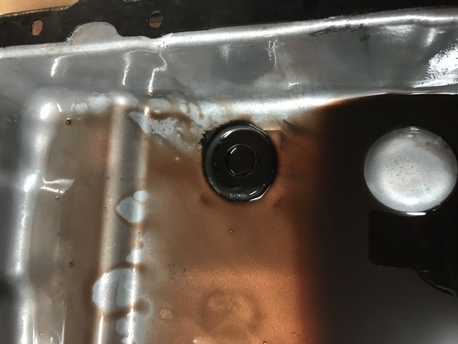

Well, I pulled the pan off today and the filter neck had a crack in it. Also, the 2-3 shift solenoid is very loose and wiggly. This is the fluid and magnet in the bottom of the pan. The little specs are rocks from jiggling the pan loose. I removed the exhaust, shift linkage bracket and front driveshaft so I wouldn’t disturb the electrical components. Also, the filter came off with little to no effort. Do you think it would still be the 3/4 clutches?
Jan 4, 2022 at 6:09 AM
You could try changing the fluid and filter and see but I doubt it will make a difference.
If it was that, then 1st and 2nd would have been affected.
