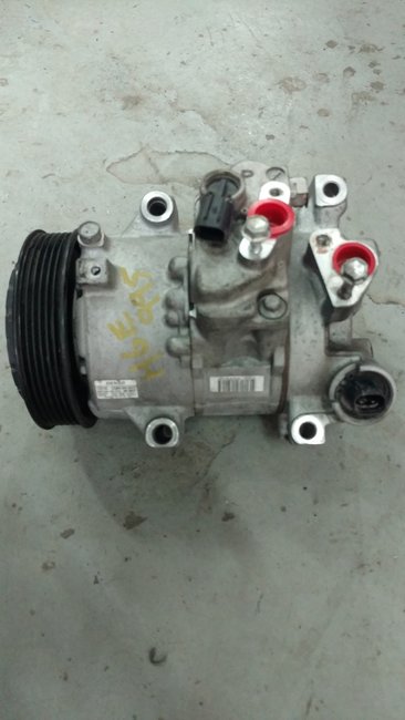

I have car made in Canada. I had replaced the AC compressor as mechanic told me compressor is not working.once replaced it was working for two months and then one day coming back from work it suddenly stop cooling. It is blowing the air but not cold.
I visited the mechanic again and he told me same thing that AC compressor not working again. I replaced the compressor and it works for two days and same problem happen it stop making cold air while on the way. My AC compressor has no mechanical clutch. Could you advise me what is the possible problem in my car AC system and how possibly I can fix it? Please
Oct 19, 2020 at 10:58 AM (Merged)
  • 55,399 POSTS
It sounds like you have a leak in the system. Please follow this guide to confirm

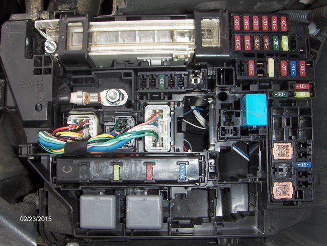

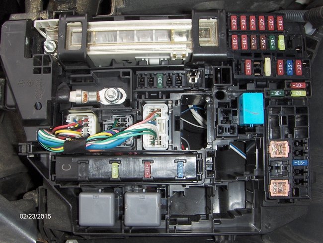

ARIF KHAN
my car's air conditioner compressor turn on and off while driving. where is the relay of air condition is in the image? it is the image of my car fuse box?
HMAC300
  • 48,601 POSTS
the system you have the compressor is supposed to work like that so it does not freeze the evaporator that is quite normal.
