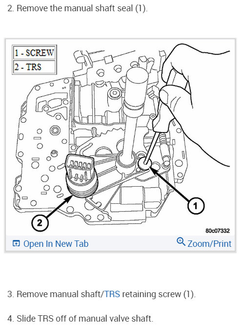

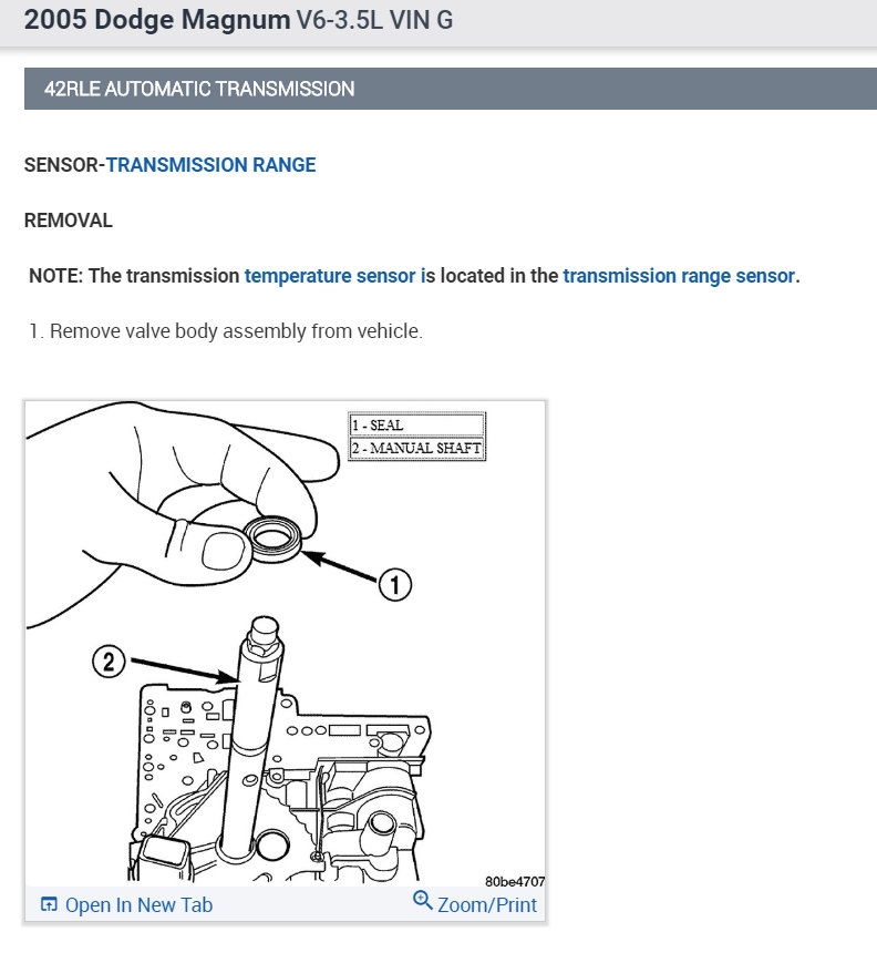

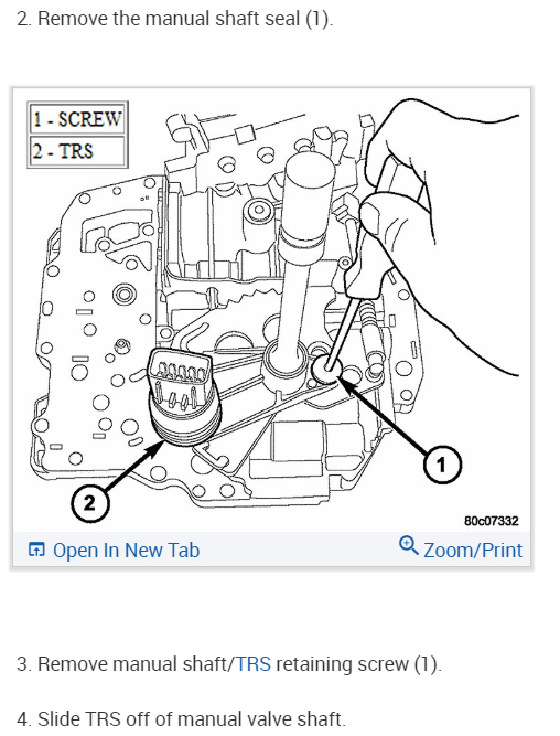

It sounds like the transmission temperature sensor has gone out or if off. Here are diagrams of how to change the sensor/switch out. Check out the diagrams (below). Please let us know what happens.

Okay, so the parts store said this was a dealer part or we'd have to order it online. I tried finding a transmission temperature sensor it kept coming up as a coolant temperature sensor or a temperature range sensor. wasn't for sure if either of these were the same part you suggested. but got into the motor checking things out and the timing chain was a notch off! Put everything back together and now runs perfect!
